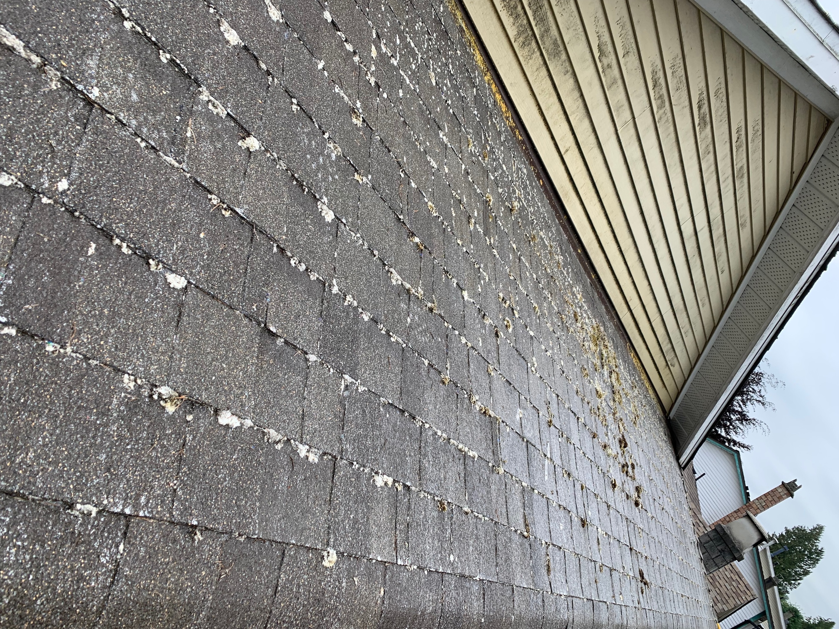

There are some moss and lichen that can never come off with soft wash.
I even tried straight SH, but the moss just stuck at the shingle edge. looks dead, but two months later, it’s still there. dry and hard, but doesn’t come off.
any thought?

The dead White moss will flow off pretty easy at that point. I follow the shingle lines ocd style and watch for the vertical shingle growth so you hit it.
I also spray the roof a few days ahead of time so rinsing off isn’t worrisome, pretty much dissipated at that time. Can do it in a day, but in this weather I would rather just spray a few and get it over with, then have a bit of a break on the rinse day being easy.
These are some of the growth areas on this one that are just chilling. Will all be of in an easy rinse. Try it with yours, that stuff is zombie moss with nowhere to go, show it to the gutter.

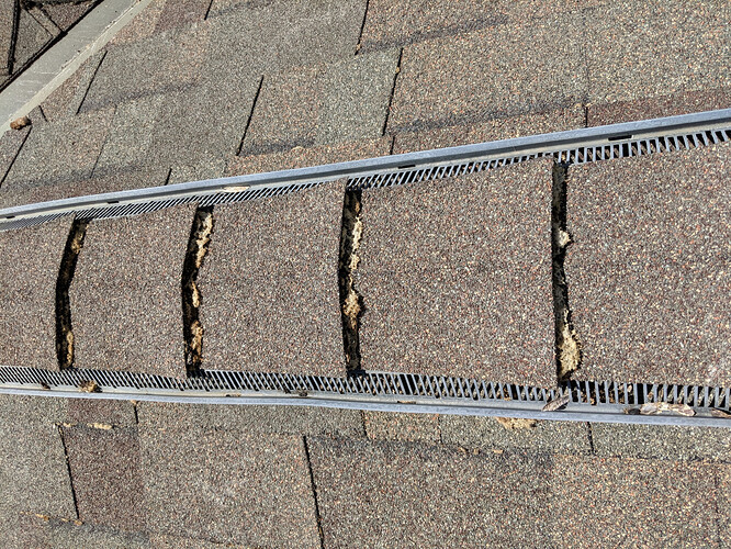

Only pain on this job was the gutter guards, so it takes some finesse to have the dead stuff float onto the gutter rather than just stream over the edge into the flowers.
