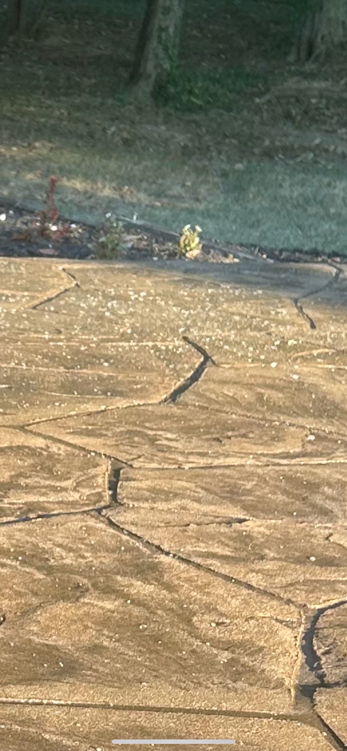

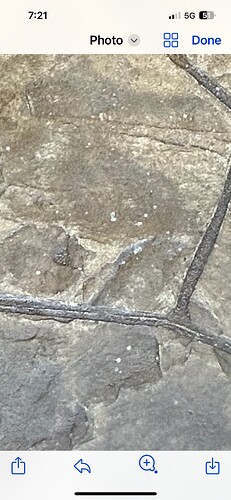

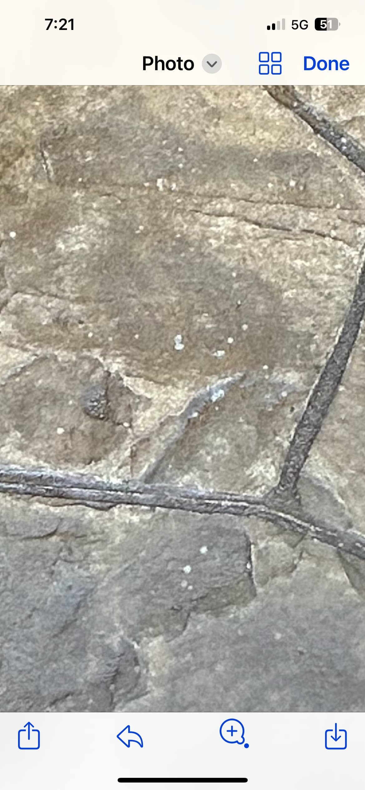

I did a topcoat sealing job two days ago and my customer sent me these pics saying the entire surface has ‘bubbles’.
Any ideas how to fix this?

Could be a few things:
-applied when temps were too hot (or got too hot)
-applied when concrete still had moisture in it
-applied too much sealer
Did you use an acrylic or solvent sealer?
Was there any old sealer remaining on the concrete when you applied the new sealer?

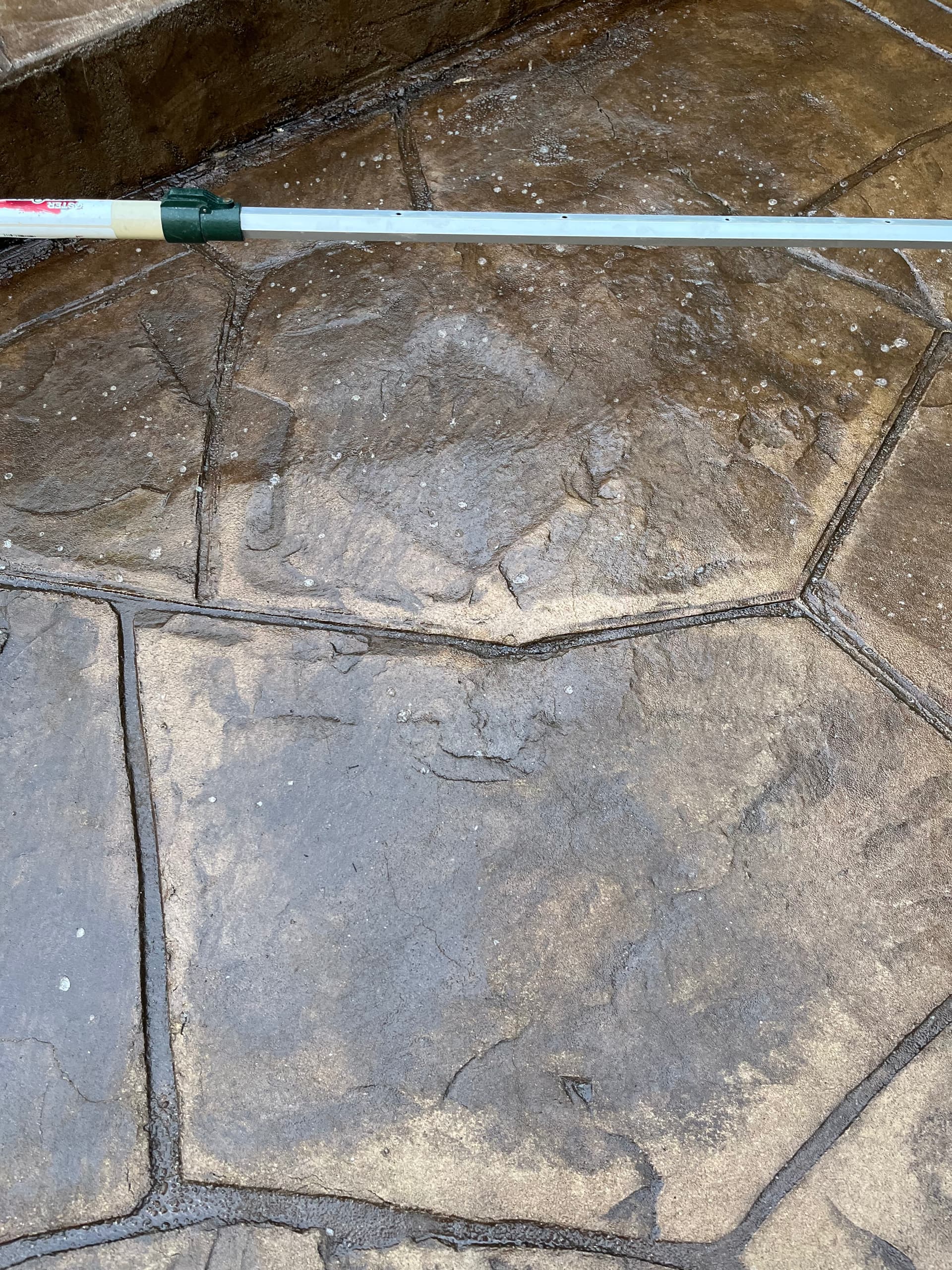

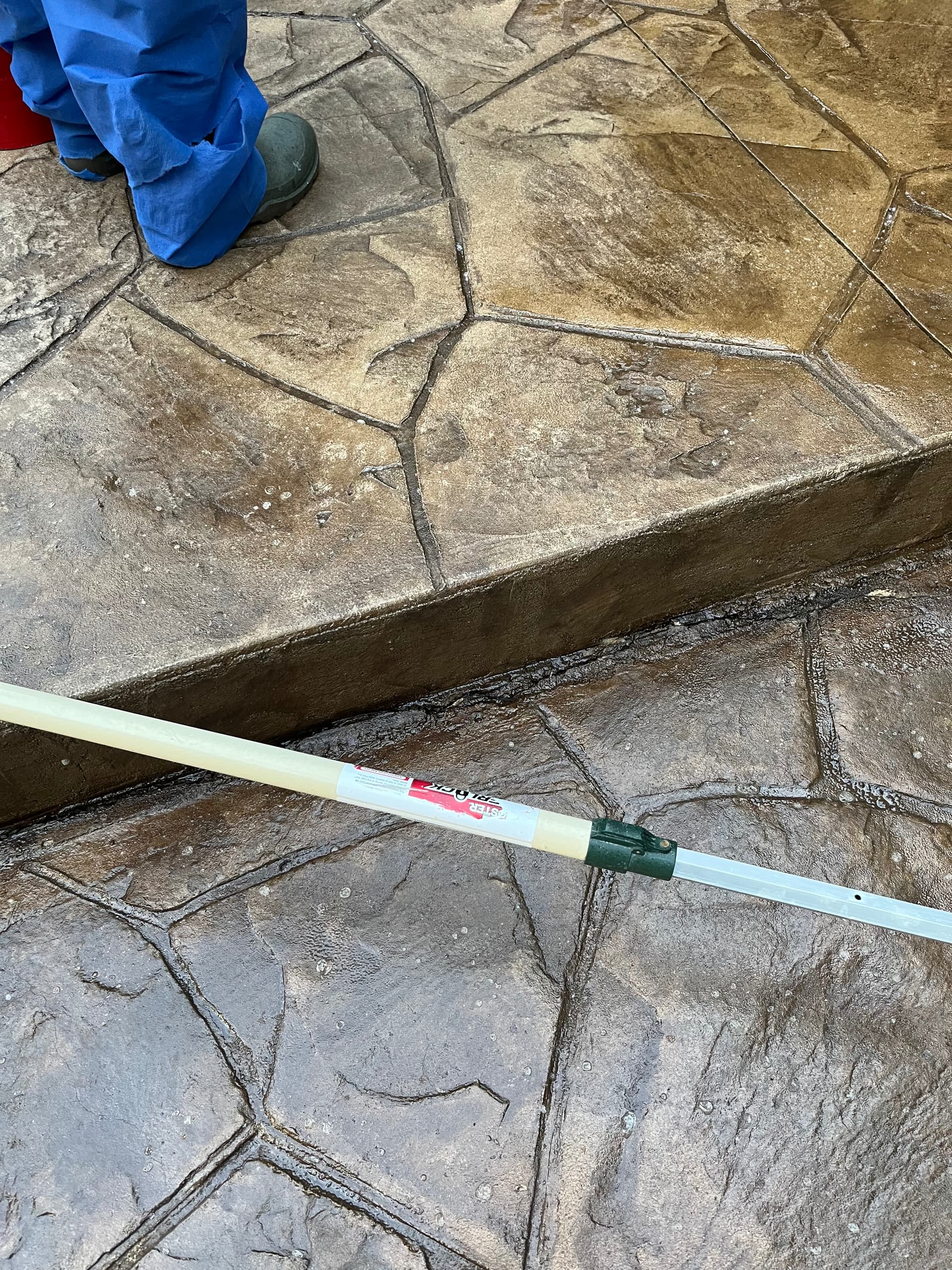

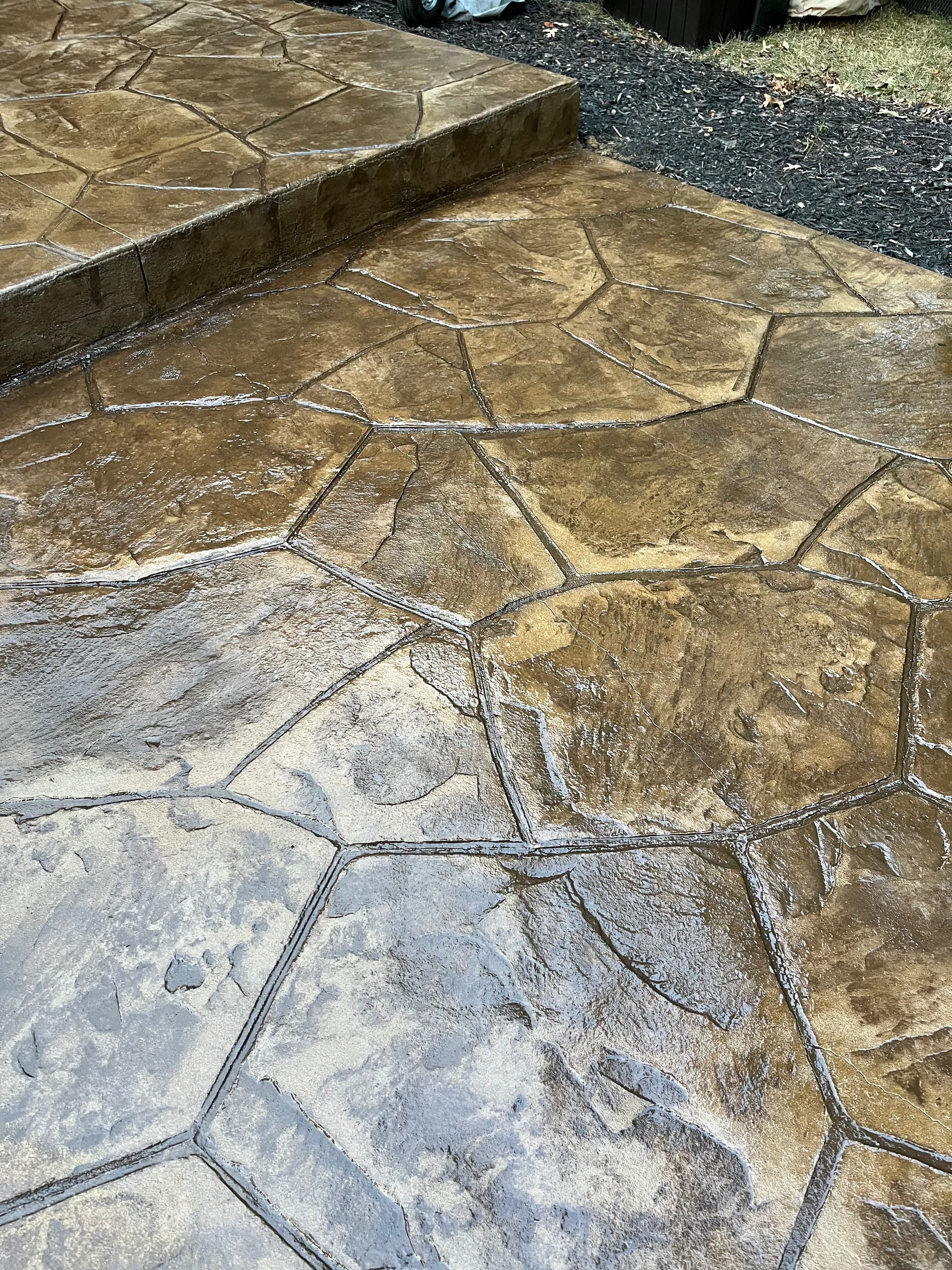

Alrighty, the xylene seems to have done the trick. My sprayer got clogged halfway through but I still got it done.
Middle pic is the ‘after’. Thanks for all the suggestions, I’m still learning.
Surface sealers are very finicky.
Got that right. I’m rapidly coming to the conclusion that top coat sealers are a real PITA. I much prefer water based like VSeal
Final update, she said it came out nice and put all the furniture back in the patio. “See you in the spring!”![]()
