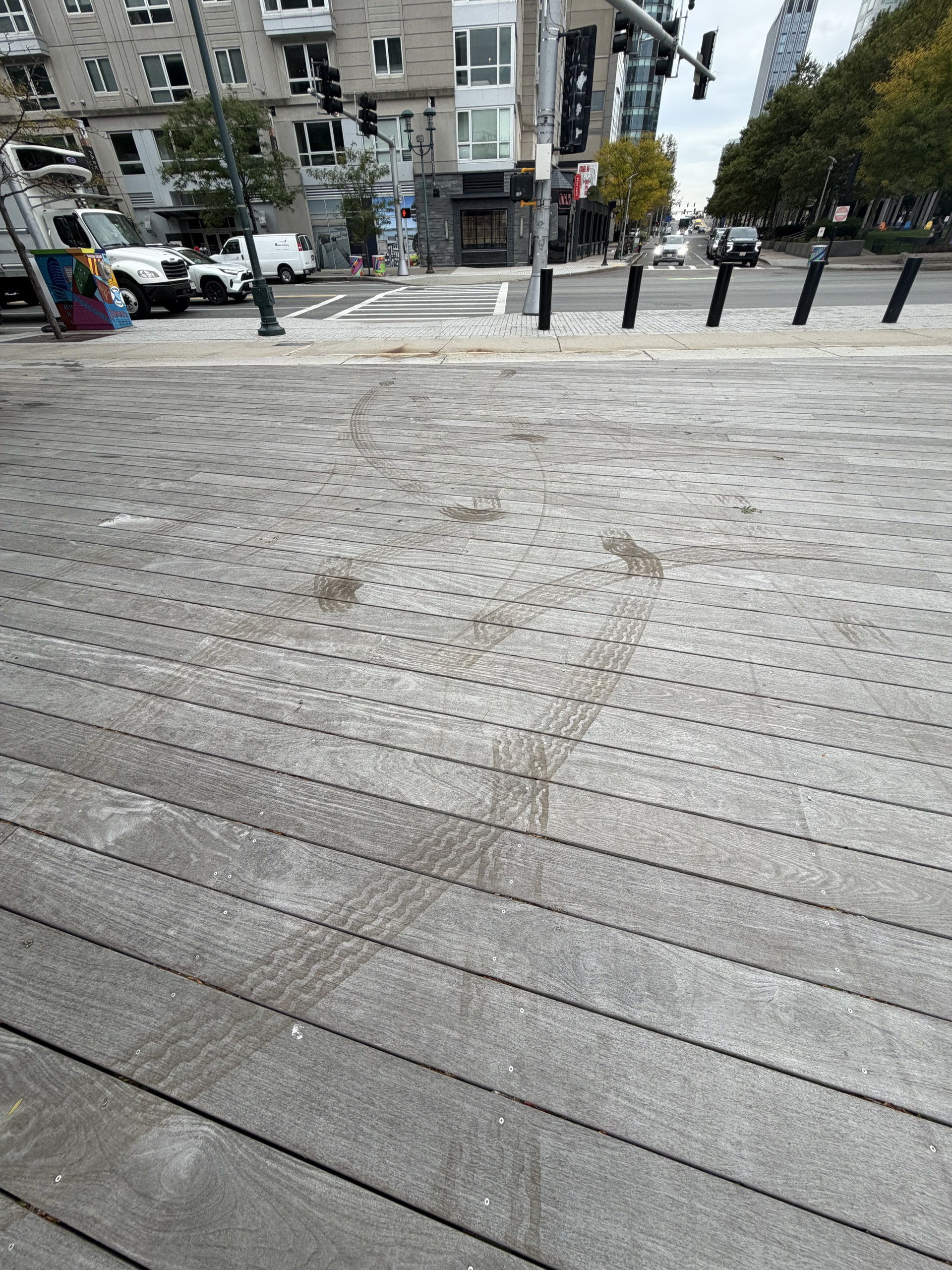

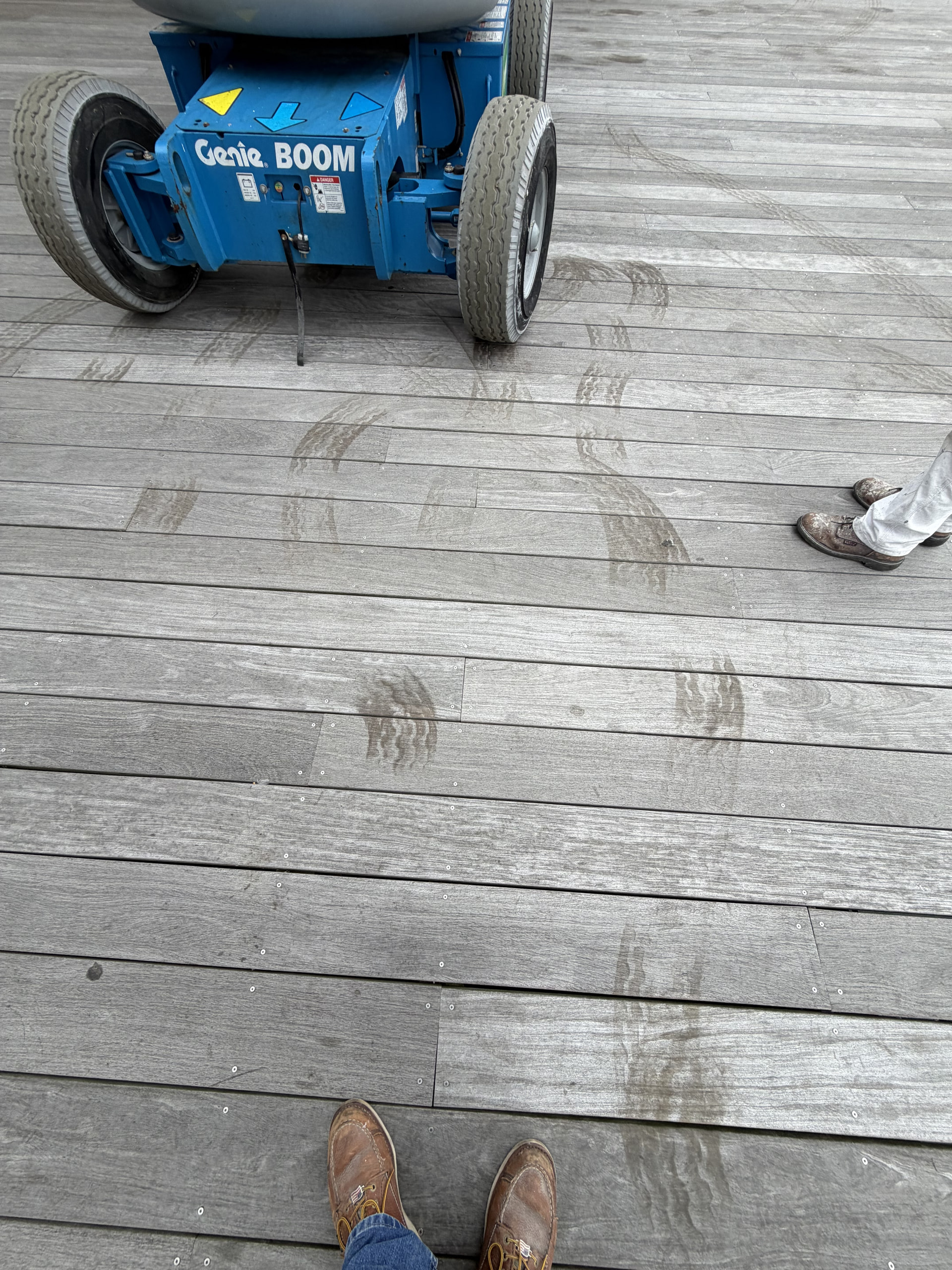

Hi guys, a general contractor I do a lot of work for sent me these pictures of tire marks on a wooden boardwalk, haven’t come across a job like this yet.. Boards are not composite, not sure what they are. They’re part of a boardwalk near the harbor. Tire marks are from a lift. What’s the best way to remove them without damaging the wood?

Respectfully, I don’t think this is ipe. I prrrrrobably do more ipe than anybody on this site (last month I did ~5,000 sq ft). I live in the land of ipe :zany_face: Here in the picture is more likely a more local hardwood which cleans similarly but not identically to ipe. Ipe is a particular species, brazilian hardwood, and has a pretty distinctive tiger striping. You could tell real quick by looking at an end grain. I would think we have here is white oak or black locust or something in that spectrum. The complete lack of knots makes me think its almost certainly not pine.

Ipe doesn’t fur like pine. That does look like a hardwood. I feel confident the tire marks don’t do down into the wood, most likely just on the surface? Did they just take off the grayed wood layer?

I think they just took off the dead wood, as you can see the tread marks where they didn’t remove that nasty grey. There might be tire marks where they turned it too tight, but that would be small. Doesn’t look damaged, looks like they just showed how neglected it has been. That is how I would advise the contractor, then see if the owners will buck up for the whole thing getting a quick redo.
Hi everyone, I finally got a chance to look at these tire marks in person and the boards that were looking at is actually composite boards, just like the decks we clean. What’s the best process and chemicals for getting the rubber tires off of composite board? Thanks.
