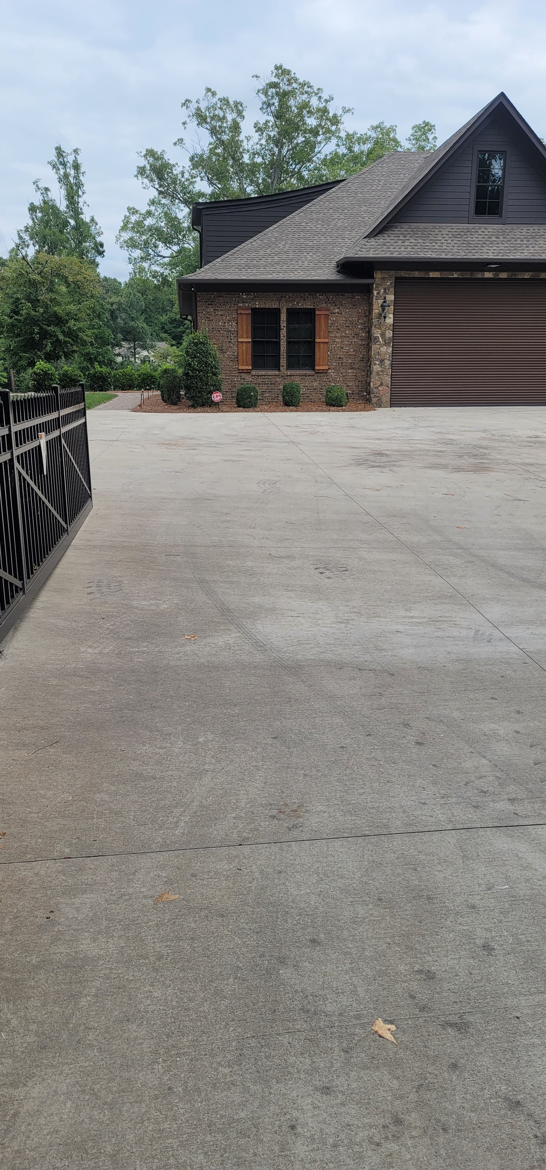

I got a call to get burnout marks off a concrete driveway. I know you can use Double Eagle and Groundskeeper, but is there something less expensive I can pick up locally such as LA Awesome or Zep that would work?
I’ve had luck with SH and heat. Do you have hot water?
BD-200 And hot water….caustic degreasers of some sort has worked for me.
You can try the cheaper stuff and see if it works.
Just realize you might be making a second trip.
But since it’s always good to have the better stuff on hand, you might as well just pick some up and then you’ll always have it.
I don’t have hot water. I do have plenty of BD-200.
You should be good then. Might need multiple applications depending on how bad it is.

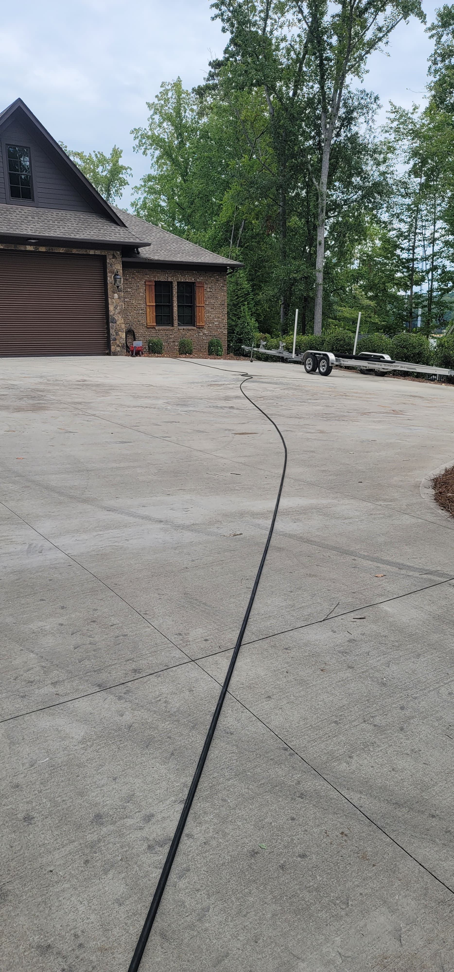

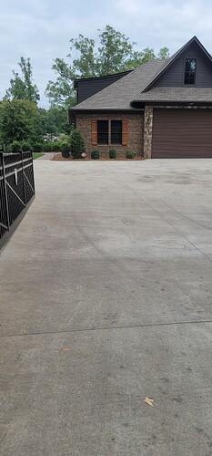

degreaser, straight.
let it dwell and scrub.
preteat the driveway, clean it as usual.
pot cleaning if needed.
post clean
…and done
