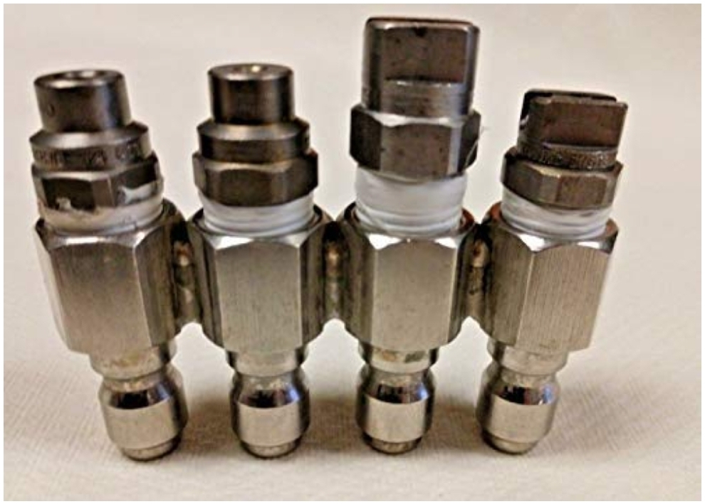

So here is what I am trying to figure out. Is there any difference in tips when it comes to jrod (I think that is what they are called) / plastic? By difference I am saying is one better than the other.
I included some pics just in case I did not yous the proper terms…
These are not my pics just screenshot off the internet.
The meg nozzles up top are welded together for easy use to chuck and unchuck from gun with qc on end, those meg nozzles also unscrew so you can replace when worn or you want a different pattern etc, bottom homeowner tips are not fixable and you have to carry them around in your pocket, wand holder or keychain, pita.
But, When ya wash rigs with 20 to 50k paint jobs and an idiot doesn’t chuck a nozzle right or the o ring wouldn’t hold it in any longer and it shots across the parking lot and hits a 20 to 50k paint job, I prefer the plastic tips below in those situations :wink:
They all do different things. You dont nesserarly need them all but you will probably end up with those and a whole bunch more. I have so many different tips and I really only use 5 or 6 on a regular basis just depends on what im doing and what’s next to what I’m washing.
@Hotshot has a great point, those homeowner ones get easily lost and it’s like carrying 10 bucks in coins in your pocket all day although they are good for grasshoppers to learn on, I just yell out a color with the new guys, they get onto it quickly like there loading a musket lol. I personally carry a 25,40, and a shooter tip on my jrod and it’s always on my gun. As you wash more stuff you’ll get a better idea of what tips to use from day to day, generally speaking washing houses 3 tips will accomodate 95% of your work.

Different nozzles get you different psi and spray pattern. You use a nozzle chart to figure out which one you need to hit a certain psi and then figure out what spray pattern you want. Say you had a 5.5 gpm machine and wanted 1200 psi. Go up top to the “1200” column. Now follow it down until you find roughly 5.5 gpm. Then follow to the left and you get a #10. Now say you want a 40 degree spray pattern. That means you’ll want a 4010 nozzle. If you have an 8 gpm machine and wanted 1200 psi follow that same column down to roughly 8 gpm. Then go to the left to see which nozzle you want.
