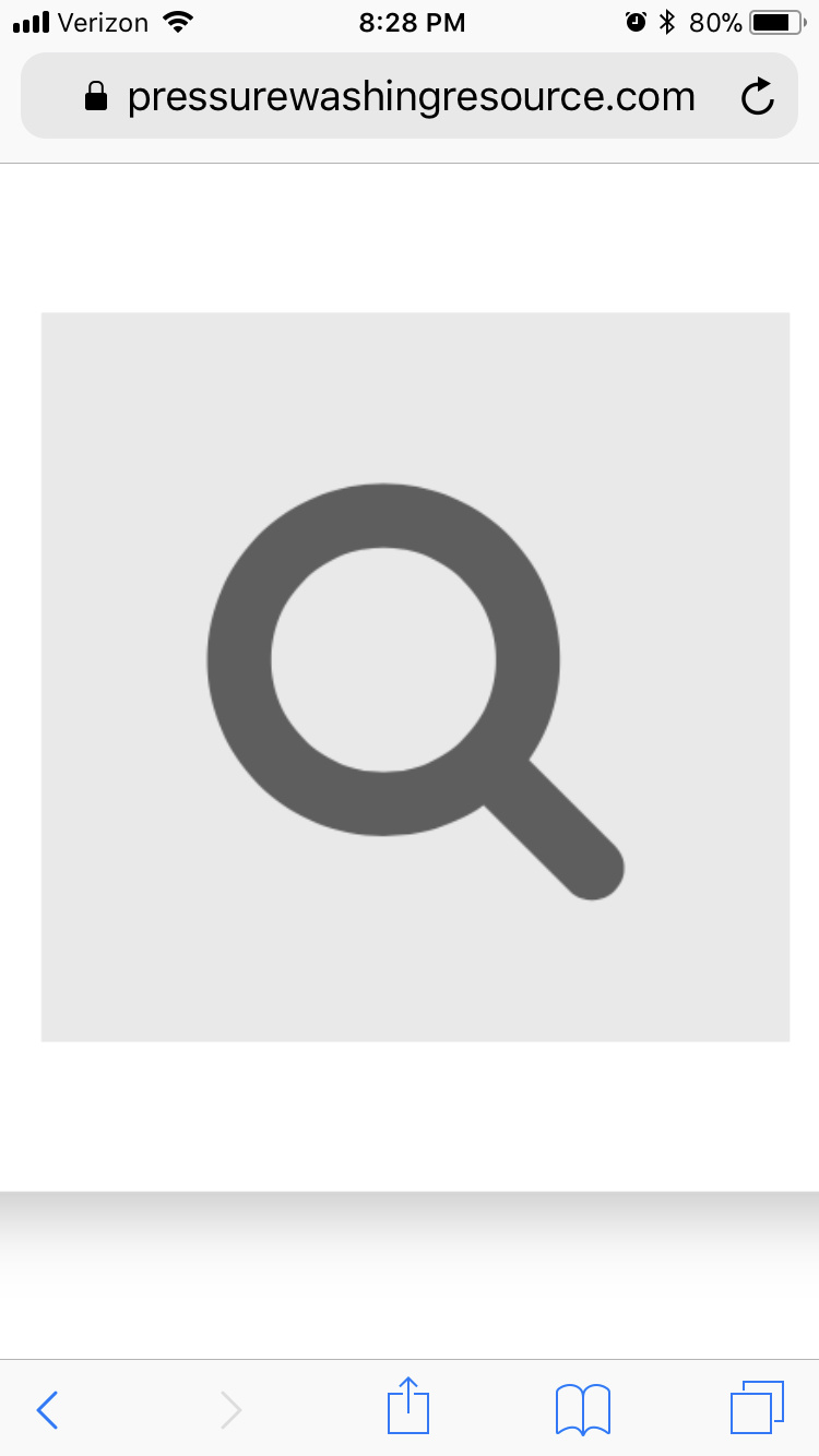

Sorry donut757 I don’t see anything but a search sign
That’s is what he is saying search function does wonders and answers lots of questions good luck
