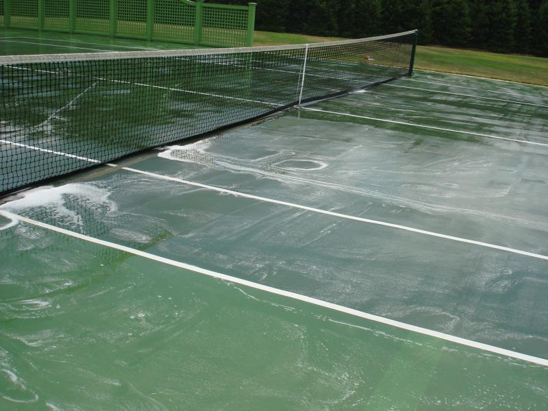

Tennis courts are no bargain. Borderline headaches at times but when they pay well I come running. Here’s one of the ways we clean them with just x-jetting soap all over them… I have another picture somewhere maybe on my website where we are using surface machines on a tennis court. If I can find them I’ll post them here.
