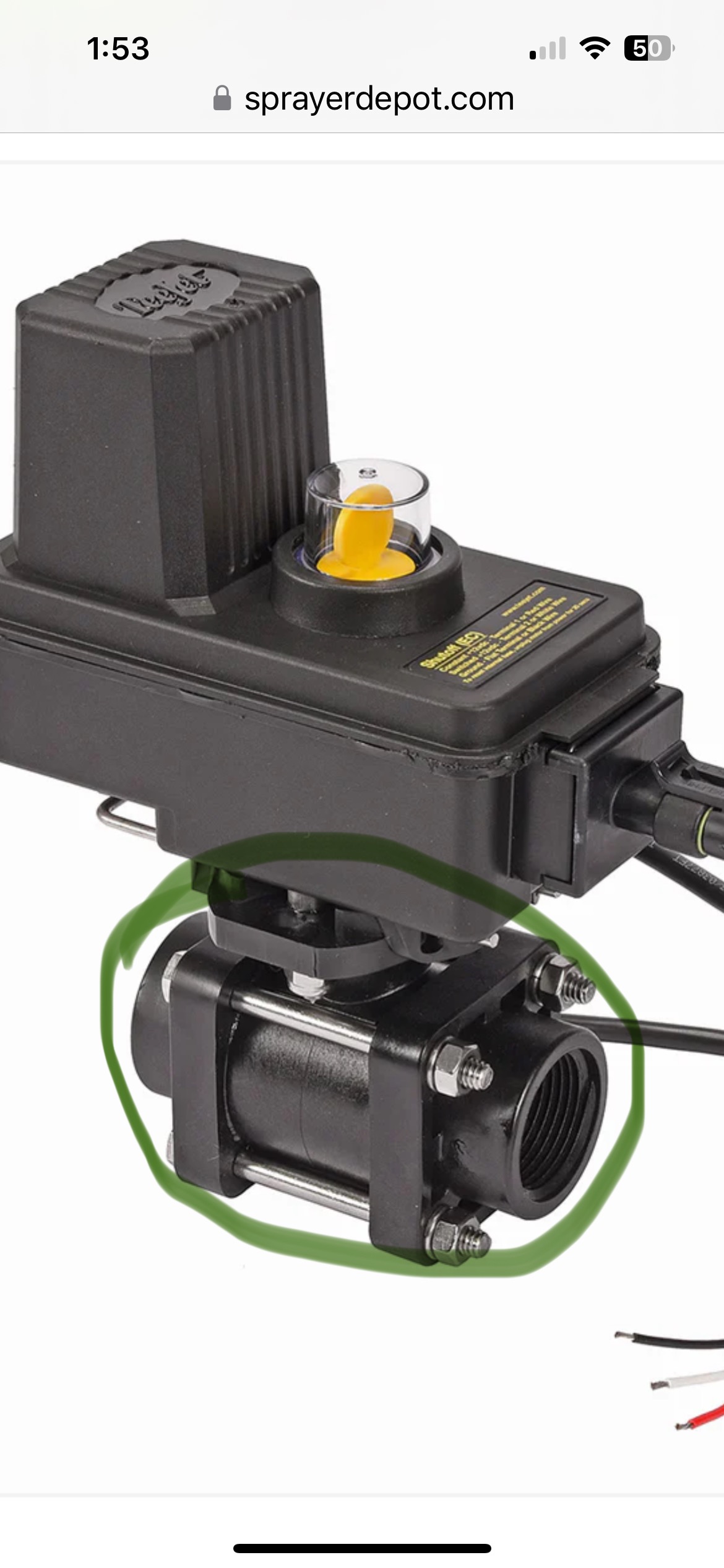

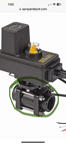

In case anyone needs a visual.

Anyone know where I can get the entire bottom ball valve assembly rather than replace the entire unit? I refreshed the seals last year but it still doesn’t completely shut off soap/bleach flow half the time.

You use a dn10 ball valve, no chemicals go thru the ball valve. The main part outside the ball valve is the actuator. Nothing like those blue Amazon junk valves that last a month or two. I’ve had mine several years, amazing remote ball valve. You should try one, well worth it.

I just discovered I can just get the parts I need.
It does say 1/2” or 3/8”, how do I know which size I need?
Ball valve size….mine is 3/8”
Think you will need these too.
