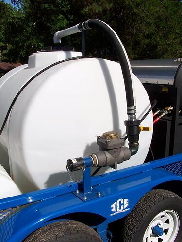

If you’re quick filling you’ll need 25" of 2" fire hose. This will screw into the hydrant’s small port. If the meter does not have a backflow device the municipality may require you to have an “Air Gap” backflow device mounted before they issue you a meter.
Looks something like this…

I see the city workers doing this often but i can guarantee i would not be allowed to. And yes there is supposed to be an air gap to make sure there is no back flow for posible contamination of the water even though the meter you have to rent has a check valve
