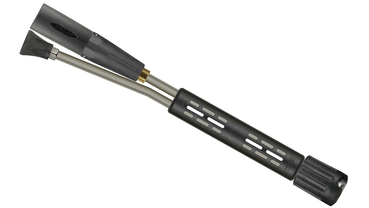

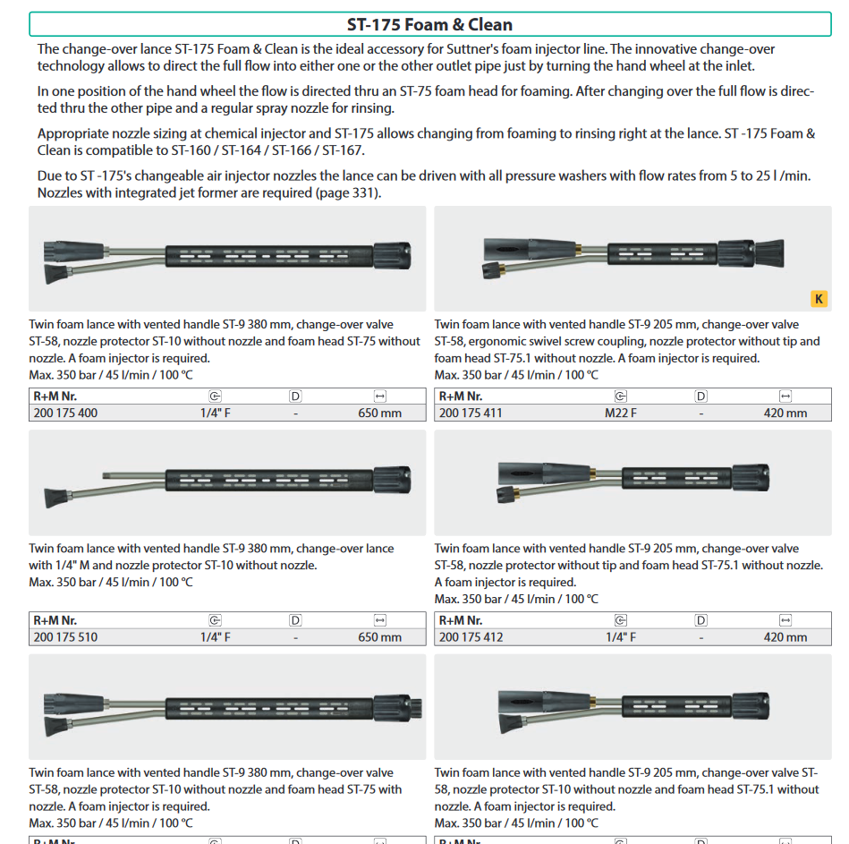

Please be patient with me, but I don’t understand completely why it only takes in from the injector when the foam canon is used?
Could this also work with say xjet M5DS on one tip, then a j rod on the other tip?
And you could easily switch between foaming and cleaning?
Will be used with a st 160 or st 166 injector.
It looks pretty easier to switch between foaming and cleaning just like it is. The reason it picks up from the injector on the foam side is because it is a lower pressure.nozzle.
