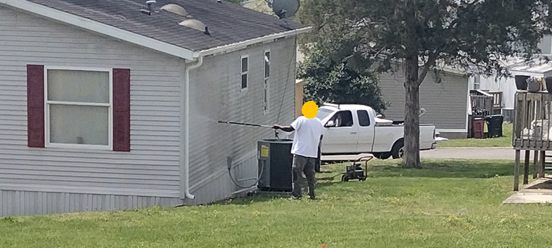

I spotted a competitor hard at it today. I should have walked over & asked him about his surfactant of choice.
Oh dang is he using a turbo nozzle??
If I had to guess, I’d say that’s probably the siding slayer 6000 series super charger nozzle.
