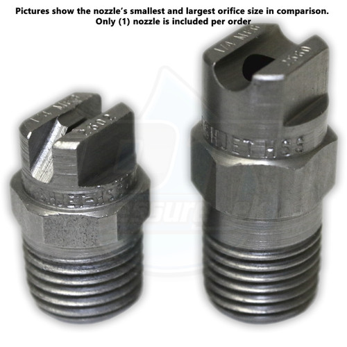

are these the right nozzles, im using a 5.5 gpm 2500 PW with a 19" Whisper Washer classic with 2 nozzles?
Get 4 of these so you’ll have two spares. Quarter inch, not eighth. My first link was before i knew what you had
Thank you so much man, I looked at the calculator and came up with the 3.5 is that correct?
I would go with the 3’s
ok great man thank you very much
