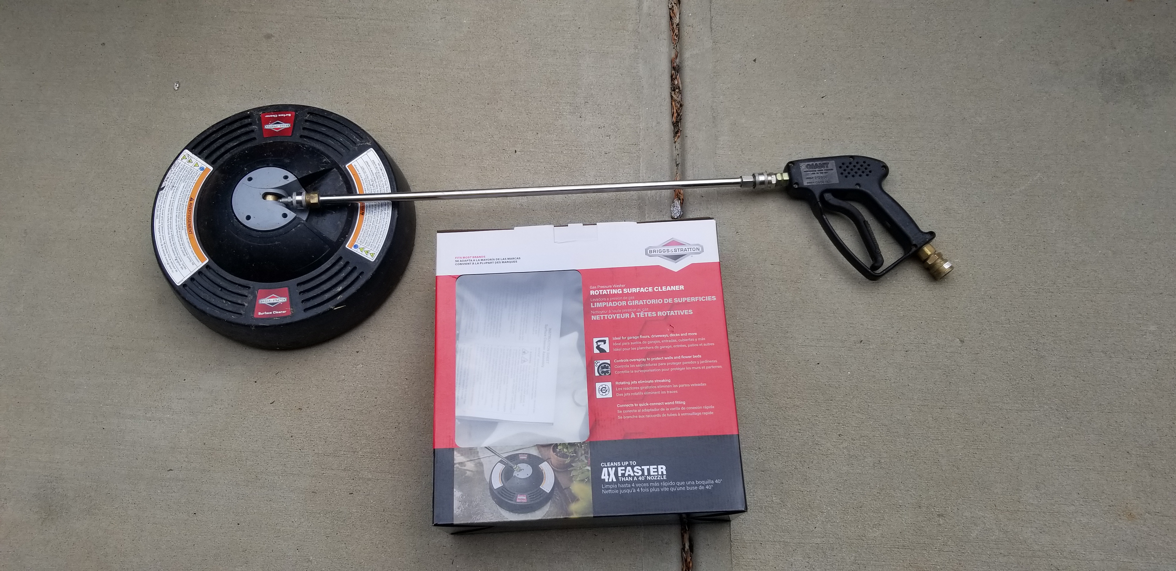

Hello. I have read that a couple of you use small surface cleaners for cleaning large sections of wall. Are you guys talking about the Briggs/Straton 15in that can be purchased at Lowes? If so, What’s the maz gpm you can put through one of those things and how long do they last?
You can probably go to the store online or I. Person to get the specs. I doubt there are many folks here using that equipment. Maybe mosmatic not b&s surface cleaner.

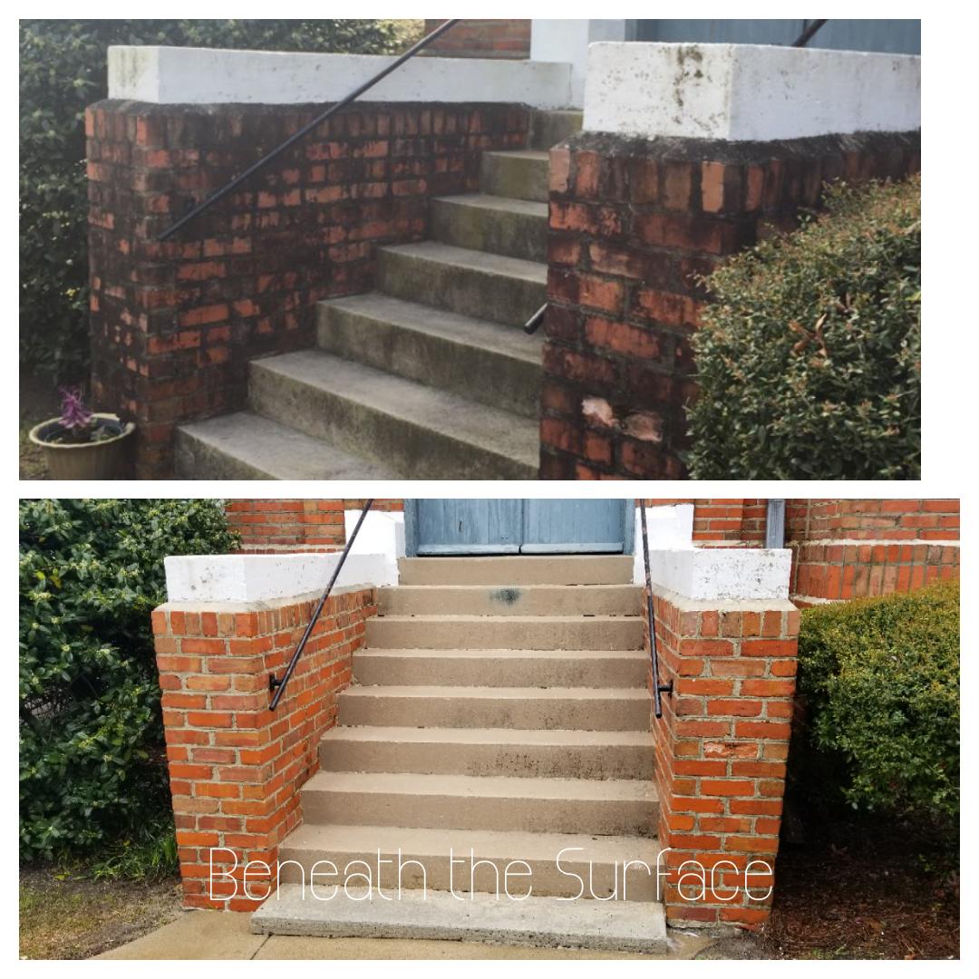

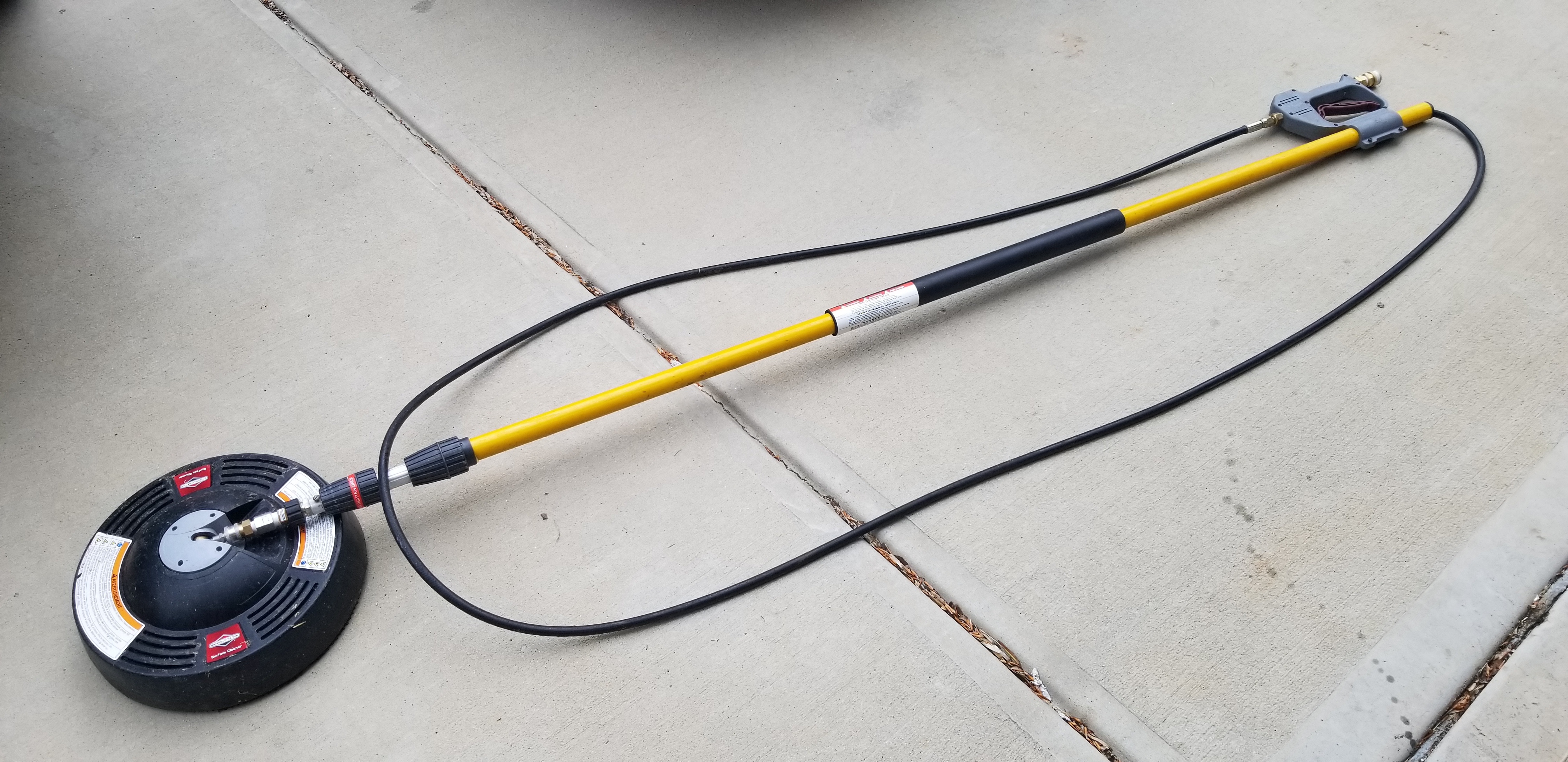

Ok guys so I found this video and decided to take a chance! I never used my extension pole so I had to dig it out the attic and modify it a bit to make yesterday’s job a huge seccess!!! Powerwash on Bricks House - YouTube

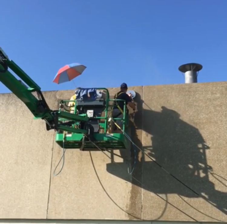

I ran this thing on an 8gpm machine all day yesterday!
Say what you will about the mans methods, but I for one really appreciated the tip and will use it to avoid wanding whenever I can!!!
Sometimes when we try to be efficient we overthink it and backtrack… just saying image|502x500
Hard to believe you ran that on an 8. My surface cleaner broke on ajob with one small section left so I bought one of these. I could barely keep it on the ground with a 5gpm. Couldn’t imagine it on an extention pole at 8gpm. Results look nice though
I though it was going to blow up as well! But I just rationalized it as it wouldn’t accept any more water than its rating and the rest would bypass back to the tank and kept right on getting at it!
that sounds bad for your machine.

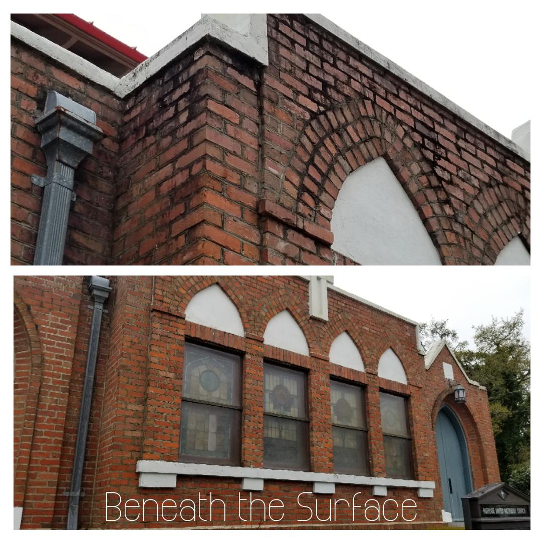

Yeah, it sounded like the SC was going to explode eventually on the first video. I give the guy props for getting it done but I think it would have been faster to use a 4% solution and a wand.
On the church I am not sure. Certainly interesting.
