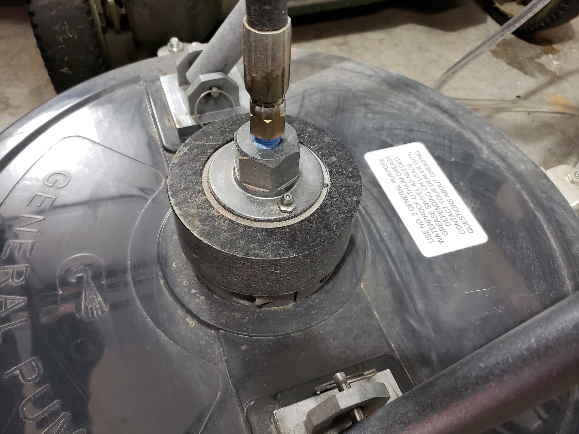

I made this for a weight on mine. Stock the back lifted badly. Put the 90 on, it was better but the front wanted to lift. Made up this weight, it’s about 3.5 lbs. Works great now. Steel bar stock bored out and several thick coats of paint. I go about 1/4" big on the ID, then use foam tape. It’s a snug fit around the union. I can pull it off, but it won’t fall off when carrying it around.
