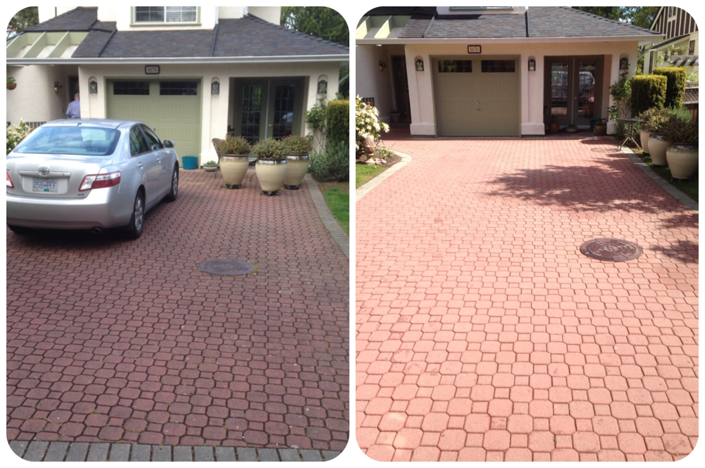

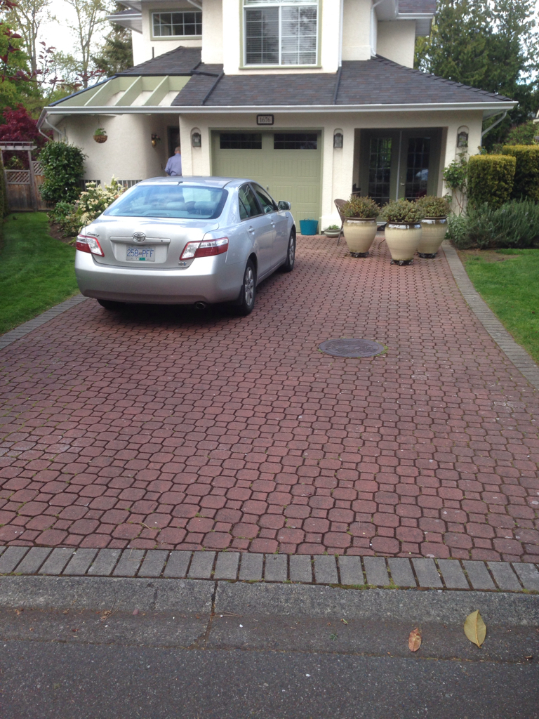

Bringing up an old thread but I am placing a quote on this drive way, I was thinking Pre and post treat with house wash mix. I am hoping to use a surface cleaner but wouldn’t that blow all the sand out of the joints? Or should I just go back and fill them with sand after??? Thank in advance! Also what would you guys price this at?

Depends! Some sand will come out, but it may not be enough to resend. Just make sure you let the client know that if it needs more sand, it’s a different price.

Perfect, I had 2 bags left over from another job so I’ll bring that along. I told her $80 for sand and install at the end.
