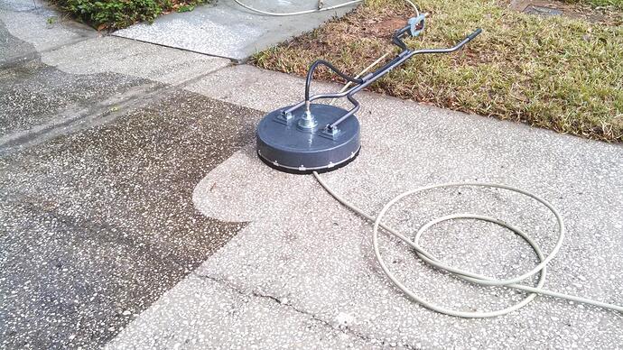

Cream is the thin coating on top of the driveway. Underneath it is usually some sort of aggregate. If you can see the white stones in the concrete in this pic. This is an old driveway where the cream coat has worn away. On newer driveways you can’t see the aggregate(stones).

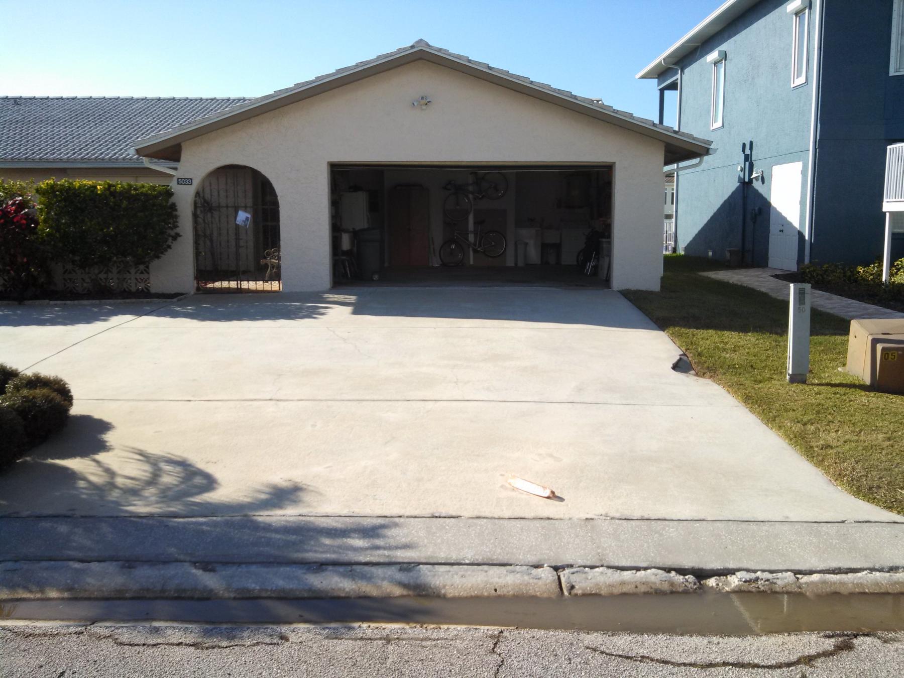

Here is a driveway with the cream still intact.

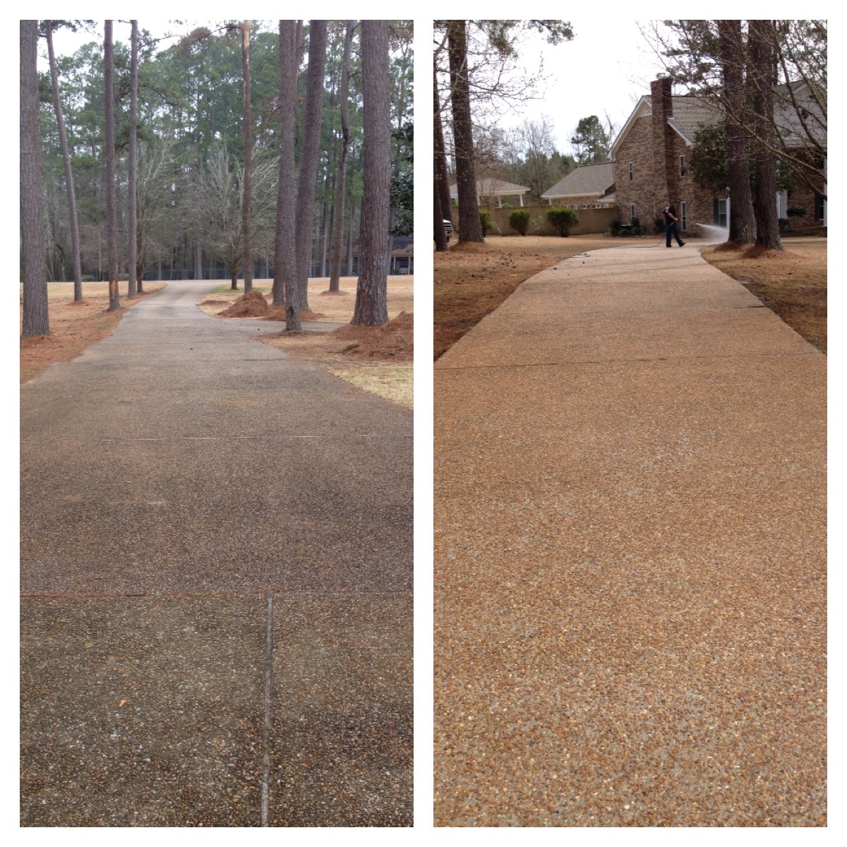

Darren, have you tried to clean it already? What chems and dwells have you tried? If you are using the right chemical application, 2000psi should be plenty on smooth concrete. The exposed aggregate drive I did the other day took all the pressure and chemicals I could put on it with 160F! It had 30+ years of pine tar, grime and filth on it too though. I wouldn’t have tried that on smooth newer concrete unless it was a last resort
