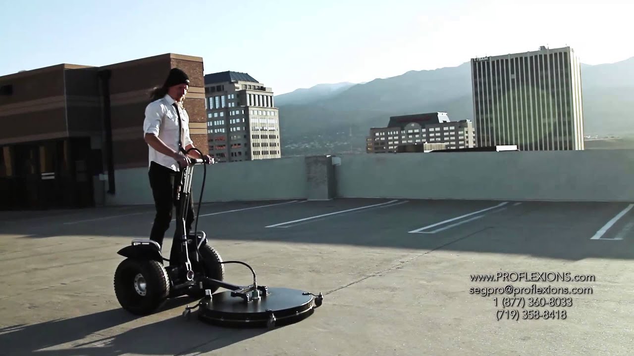

That’s the silliest thing I’ve ever seen. Soon we’ll be washing with segways.
Hey buddy, you better back off. I had the segway idea first.
If I ever see a segway at a garage sale me, a surface cleaner, and my Sawzall are going to make some things happen!
Segways, no too small and not as comfortable have yall seen one of the zero turn mowers set up with a surface cleaner for the deck of it?
Son of a bi…
