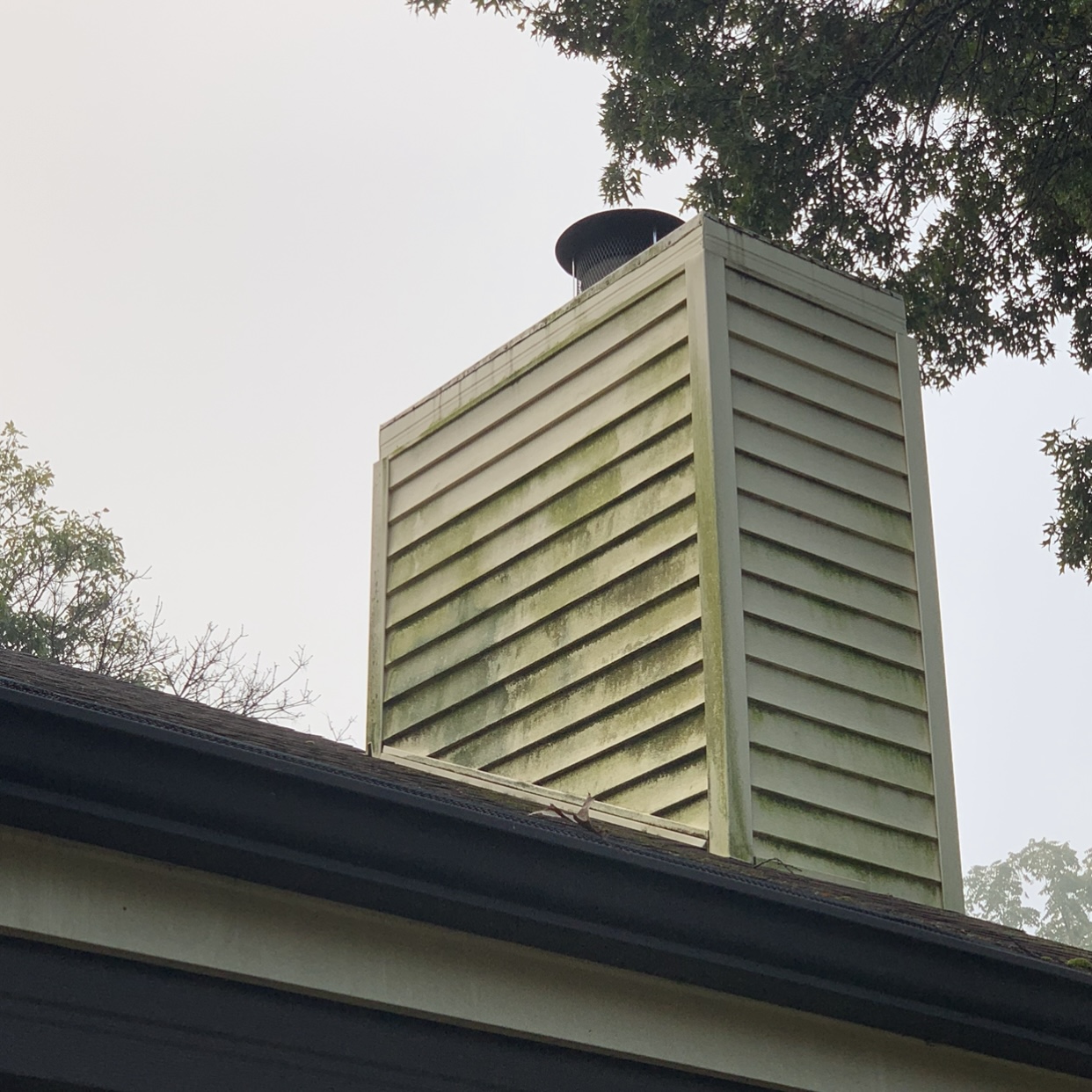

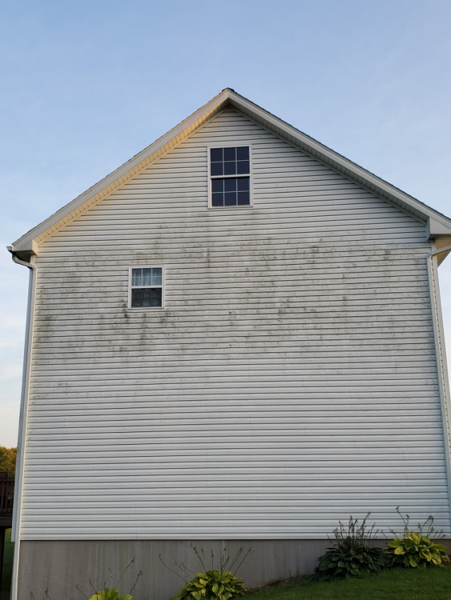

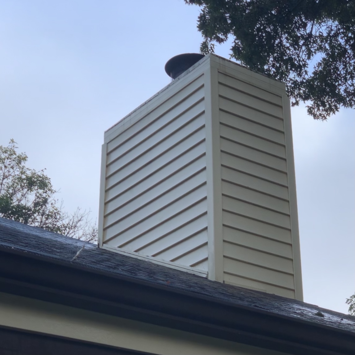

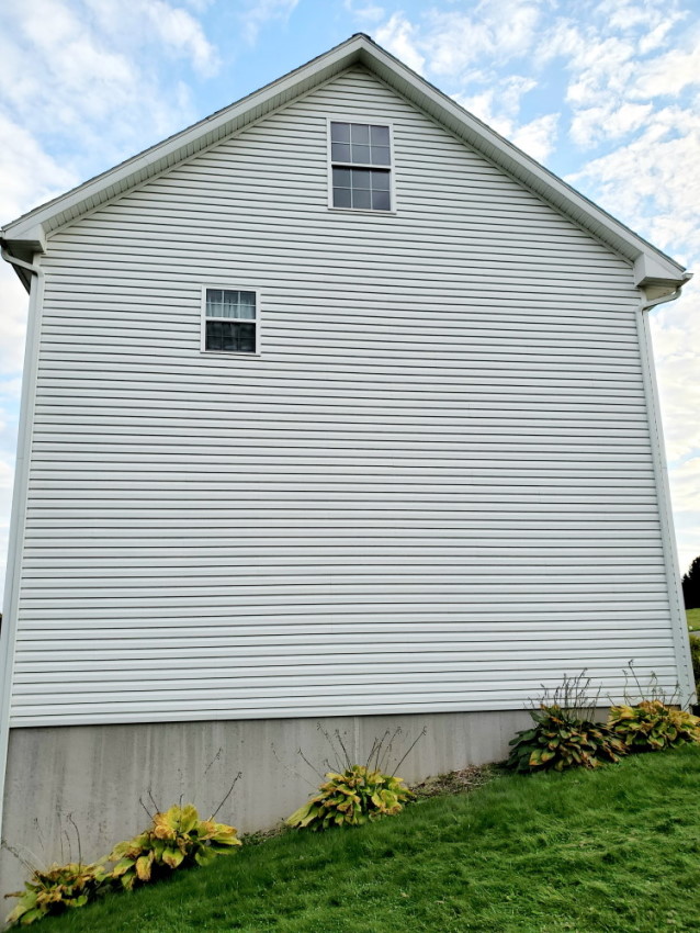

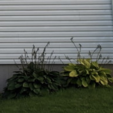

All in all, I was very happy with the results. Here are pictures of my north facing wall, which was by far the worst:
Before
After

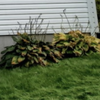

As I indicated above, everything turned out great, and nothing appears to have been harmed, including plants.

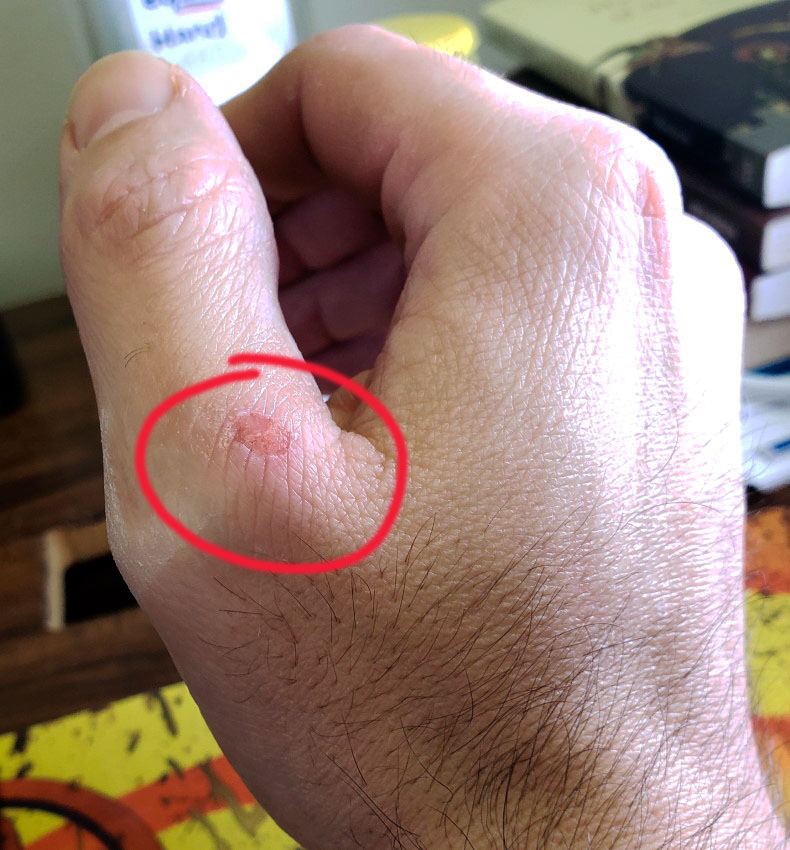

There was, however, one problem. By the time that I was finished, my hand was in pain. Specifically, the skin is badly chafed directly below my thumb, here:

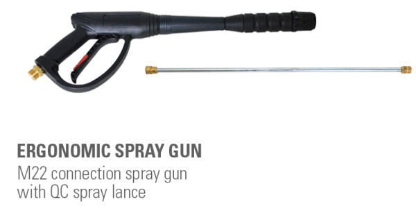

What is the best way to avoid this happening next time? Should I wear gloves? Or is the problem my gun?
I am using the spray gun that came with the pressure washer, which is this:
Would you recommend using something else instead?
