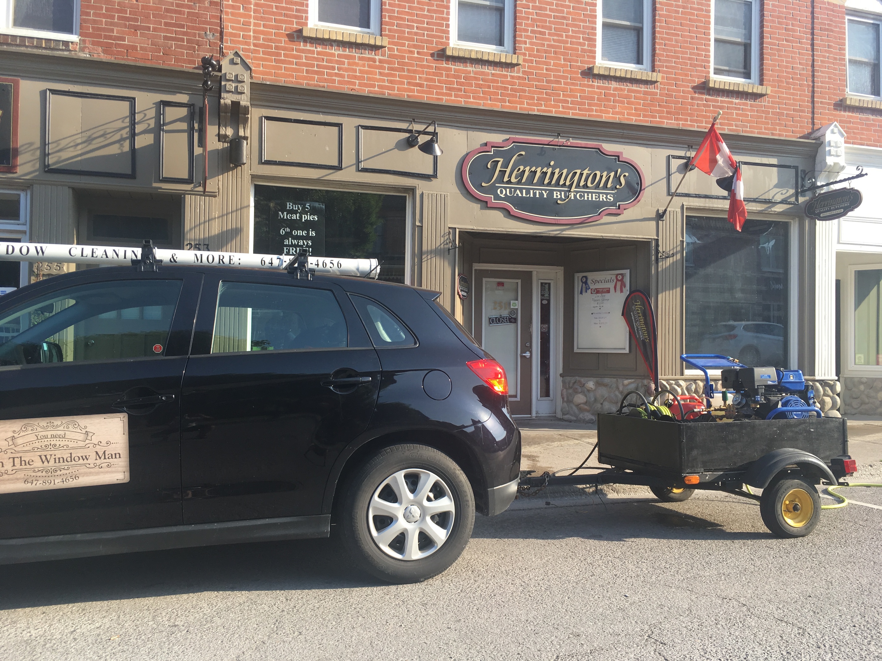

I started offering “store washing” at the rate of $100 per unit, plus tax. Including setup, and tear down, takes me half an hour per storefront. I tried to quote $150 and got push back. $100 seems like the magic number. This example is a client in Port Perry called Harrington’s.
I did 2 stores at 8am, and was done at 9am. Made $200, and then did my window route in the same area. It was a nice add on. Also, booked 3 more clients on the same route for next week.

I also wash off their sidewalk so that everything looks nice and clean. All that done in 30 minutes easy.
Depending on the setup, you may need to run your supply hose into the store. If that is the case, bring some big towels and stuff them in the front door. No matter how careful you are, there will be some water that gets in the entrance.
