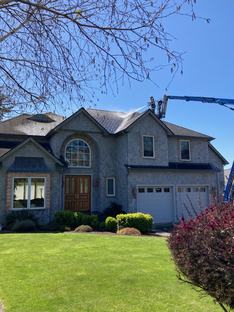

My personal limit is a 8/12 pitch on a two story. I don’t care for heights and its not worth it. I will be adding the Roof Ridge thingy with the wheel on the back. It looks good to me, but I won’t be bolting it to the ridge. I commonly rent a manlift that gets delivered day of. They are the safest option and usually around $300. Its built in the bill. Here on the Oregon Coast, we have gobs of moss that I try to remove before treatment. It looks better and keeps the gutters from clogging when the remaining moss comes off. If the roof is too steep, and the cost of a lift too high for the customer, I simply treat the roof without removing the bulk of growth before. It takes a bit longer to fluff of and clogs gutters. Hope this helps.

It is fairly simple to line up. I pay around $365/day and schedule the delivery a couple weeks out. Just plan on weather during those seasons. Also, don’t use them on saturated lawns.
