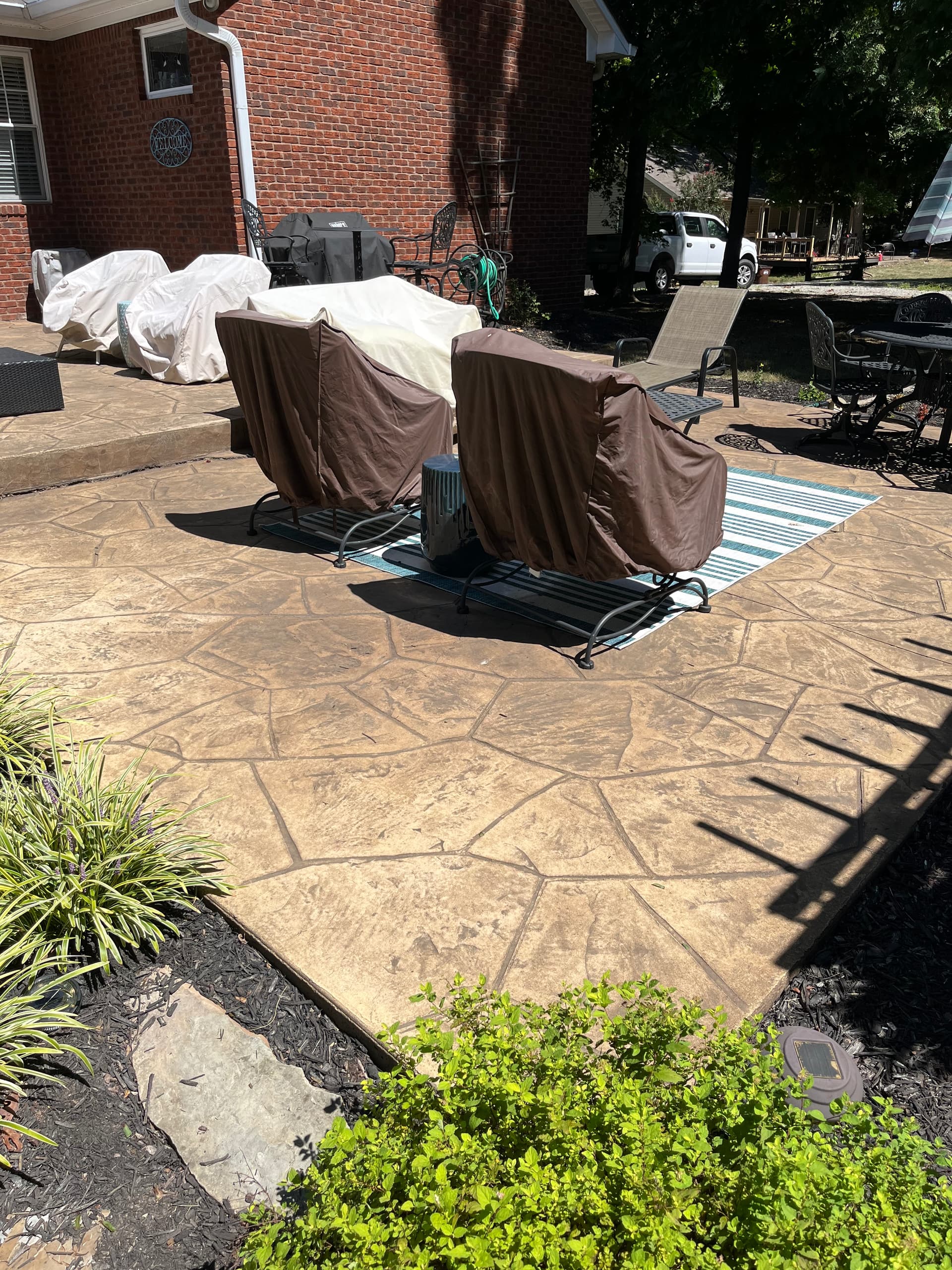

If the veteran guys here could confirm the best way to do clean and seal this patio I would appreciate it.
The customer admits she is super picky so I don’t want to mess this up. She wants a top coat semigloss so I’ll be using Diamond Clear with a traction aid. As for cleaning, will the SC take too much color out or am I overthinking this?
She said it’s been a few years since last cleaning.

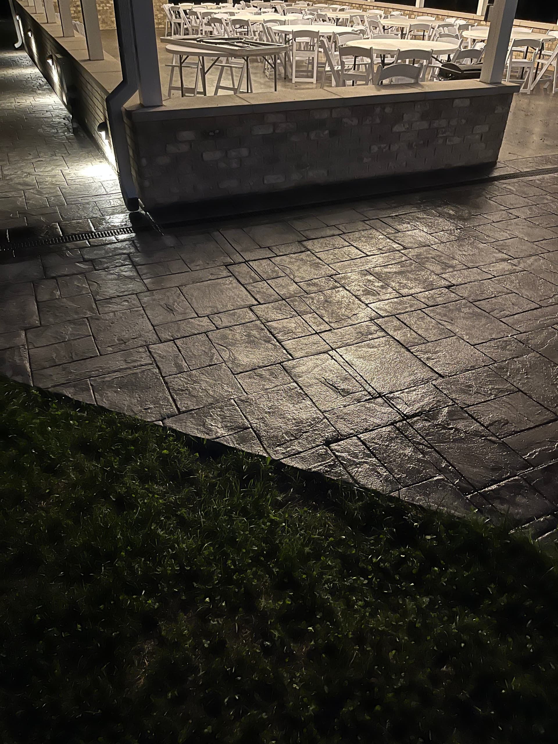

What would cause the color to wash out then? I had one patio a few years back do this and I’ve been cautious around them ever since.
I’ve had the same thing happen…..I did set expectations with the homeowner, they were fine with it. It did lighten the color, I used hw mix then normal surface cleaned….it looked fine but it was lighter than when I started…..not sure the deal but it is what it is. You want it cleaned….

Ok, so I guess to clarify, there are three main ways to color concrete.
-Integral Color (mix the color into the concrete)
-Color Hardener (after the concrete is poured and as it’s drying, you add the color “concrete” on top)
-Stains or Dyes (added after the concrete has cured; and generally a sealer is put over the stain/dye to lock it in)
So my guess is that you and Kentucky happened on one that was stained/dyed either improperly or stained years before and the protective sealer coating was gone or compromised.
But looking at DC’s pic, I just see normal colored, stamped concrete that really needs a cleaning. Do either of you have pre or post pics from those jobs? Now I’m curious!
My question for you and @Kentucky1234: Was it stamped concrete that washed out or different concrete? And did you seal it after you washed it? Because I could see newly washed stamped concrete looking washed out. But a proper sealer would bring out the color and make it look good again.
I always look at the edges of the concrete where it meets grass/rock/landscaping to see what the edges look like. That can indicate which of the three options was used (because they don’t always stain the lip/edge). I also look for pitting because that’ll show if the color runs through it or not.
The water runoff had a noticeable tint, so this is likely why I ran into it. I’ll make a point to check the edges more closely in the future. Now that you mention it, I do recall seeing drip lines along the sides of some I’ve done, almost like it was just poured over the top.
I didn’t see sealer on the stamped concrete……if there was sealer on there it came off over time.
