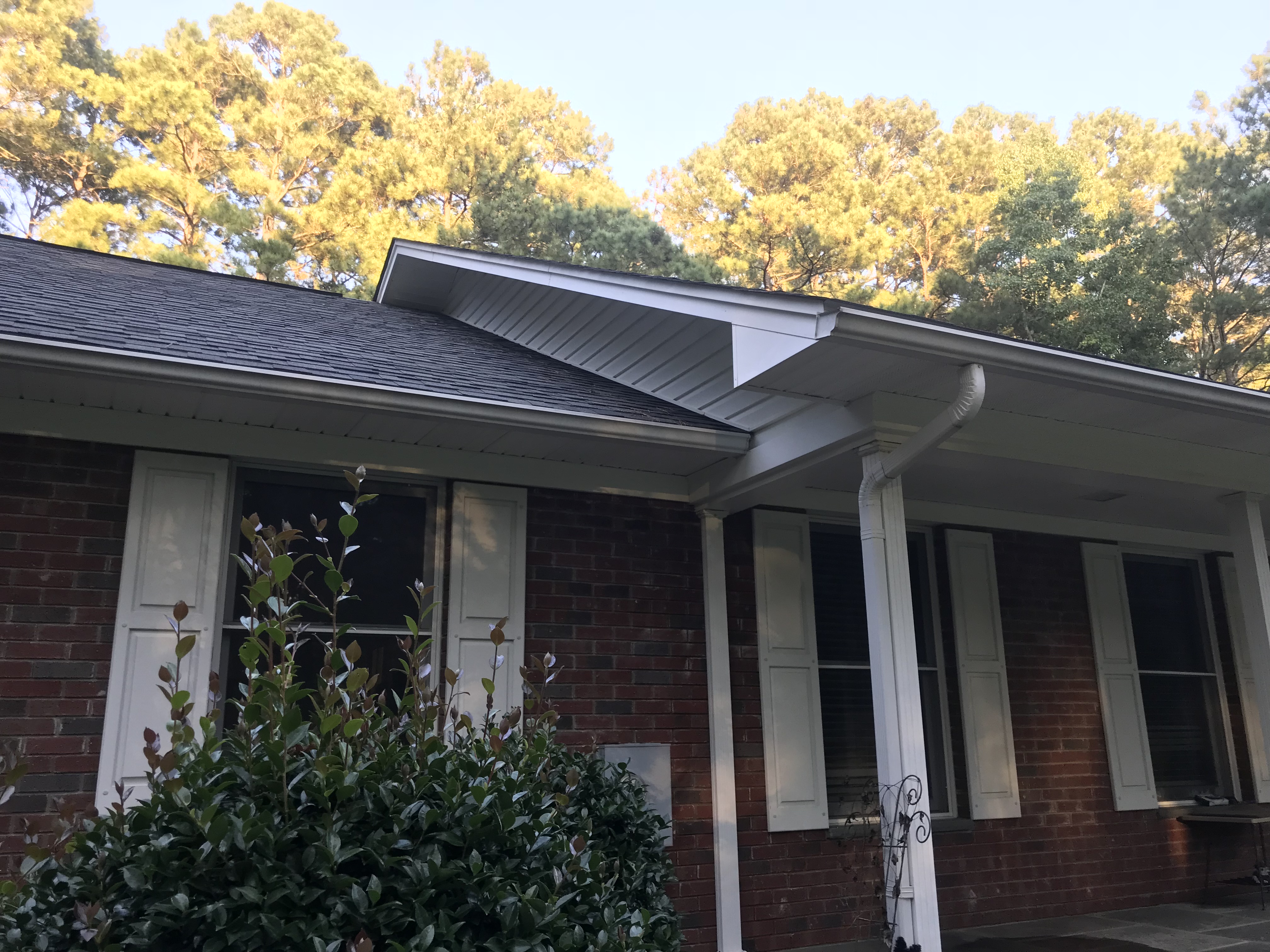

I may have my first siding softwash job soon. One section of the house is above a roof overhang, will a light Dawn/bleach solution spot the roof shingles? How do I prevent that?

You’ll be fine, it’s typically not strong enough to spot the roof. Instead of using dawn try using elementor. Also remember to use the search bar before asking questions. Lots of answers there.

Perfect, thanks. Pretty much what I’m looking at but the front of the house.
as said already HW isnt strong enough to clean the shingles enough to see
