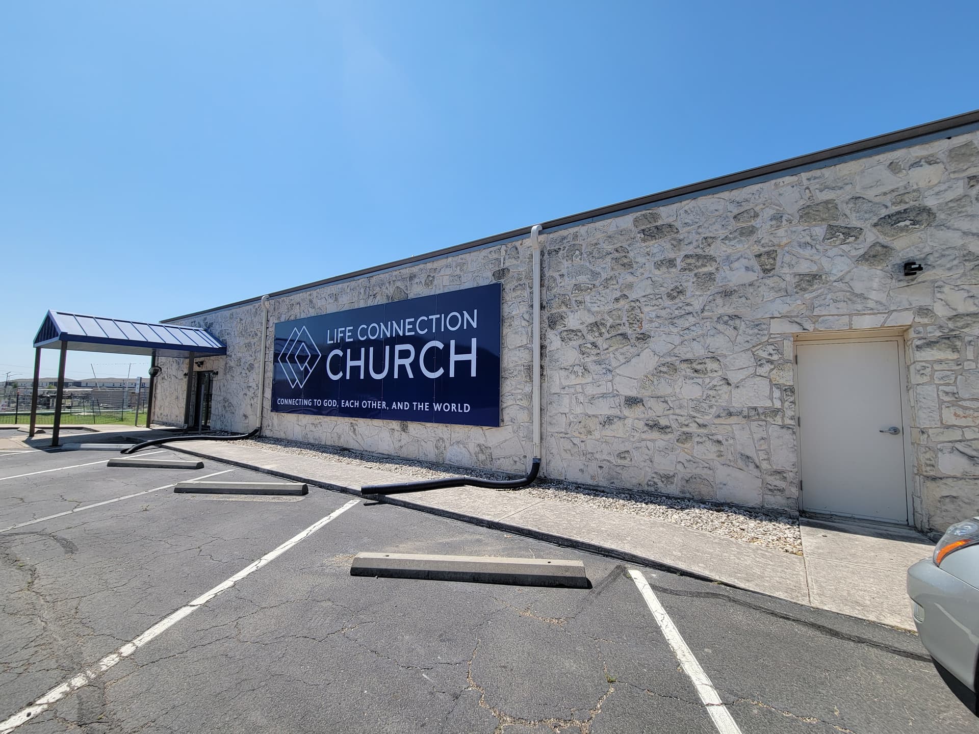

I have a commercial client who’s interested in getting the side of their church building softwashed. However, there’s a large metal sign mounted on the side of it. Not only do I want to be conscious of the hot SH mix I’ll be using (~4%), but also that their water source I’ll be using is a pretty hard water.
What are the factors/practices I should consider when trying to wash this side of the building and not damaging the sign? I washed the other sides and splashed some of their metal roofing, and after rinsing it with said hard water I didn’t see any staining or reaction. I’ve heard to keep the metal surfaces wet with the SH mix and to not let it dry. I imagine I would upcharge for that since I’ll have to use more mix. Is this job a bit too risky? Any tips helpful.
Two options:
Hit the sign with 4% mix and see what happens
or
Pre wet the sign
Spray your chems (not directly on the sign)
While waiting for chems to dwell, water down the sign again
Rinse off chems
Water down sign again before leaving
