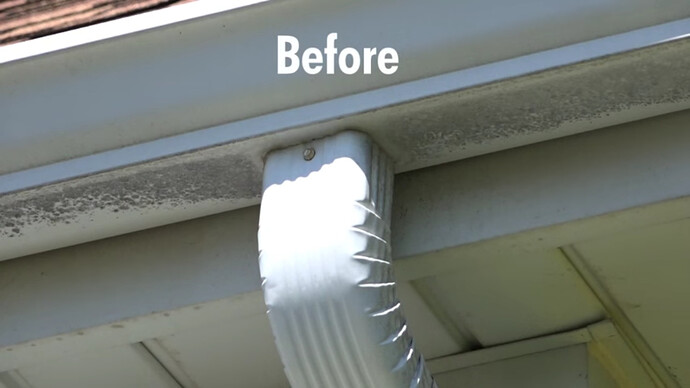

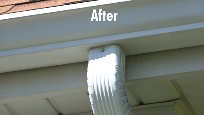

I’m going to just try using that krudcutter housewash sometime. This is what it claims.
I’ll have to look at the msds, but it says bleachfree, but also to rinsedown the surroinding vegetation…
