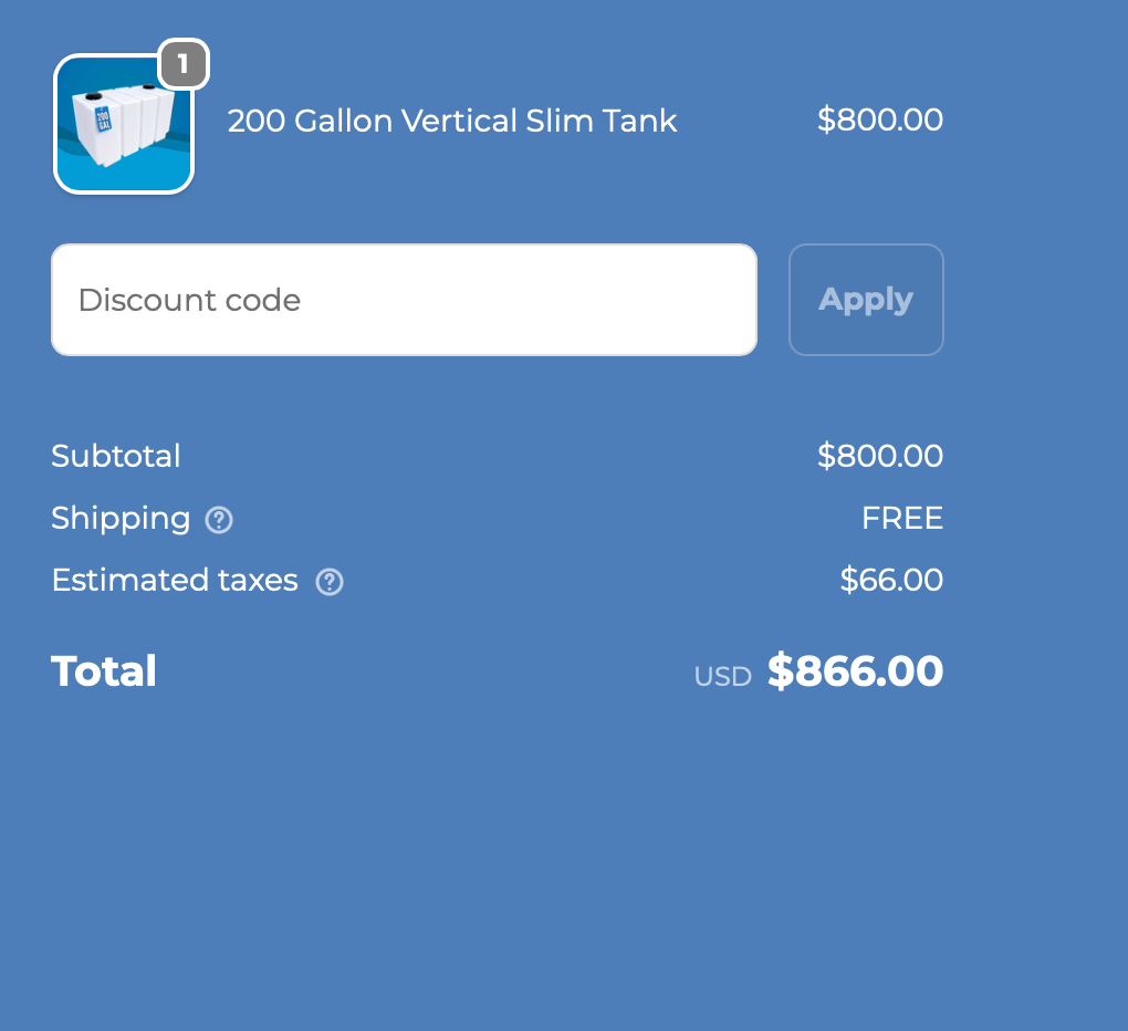

Manatee I think has them for $800 including shipping. I think I’m going to grab one for the buffer tank on this build and see how it goes
I’d be surprised if shipping were free, tanks are typically shipped via freight and I don’t know a single company that absorbs that cost.
I was as surprised as you are, but I guess they built the shipping into the price of the tank….

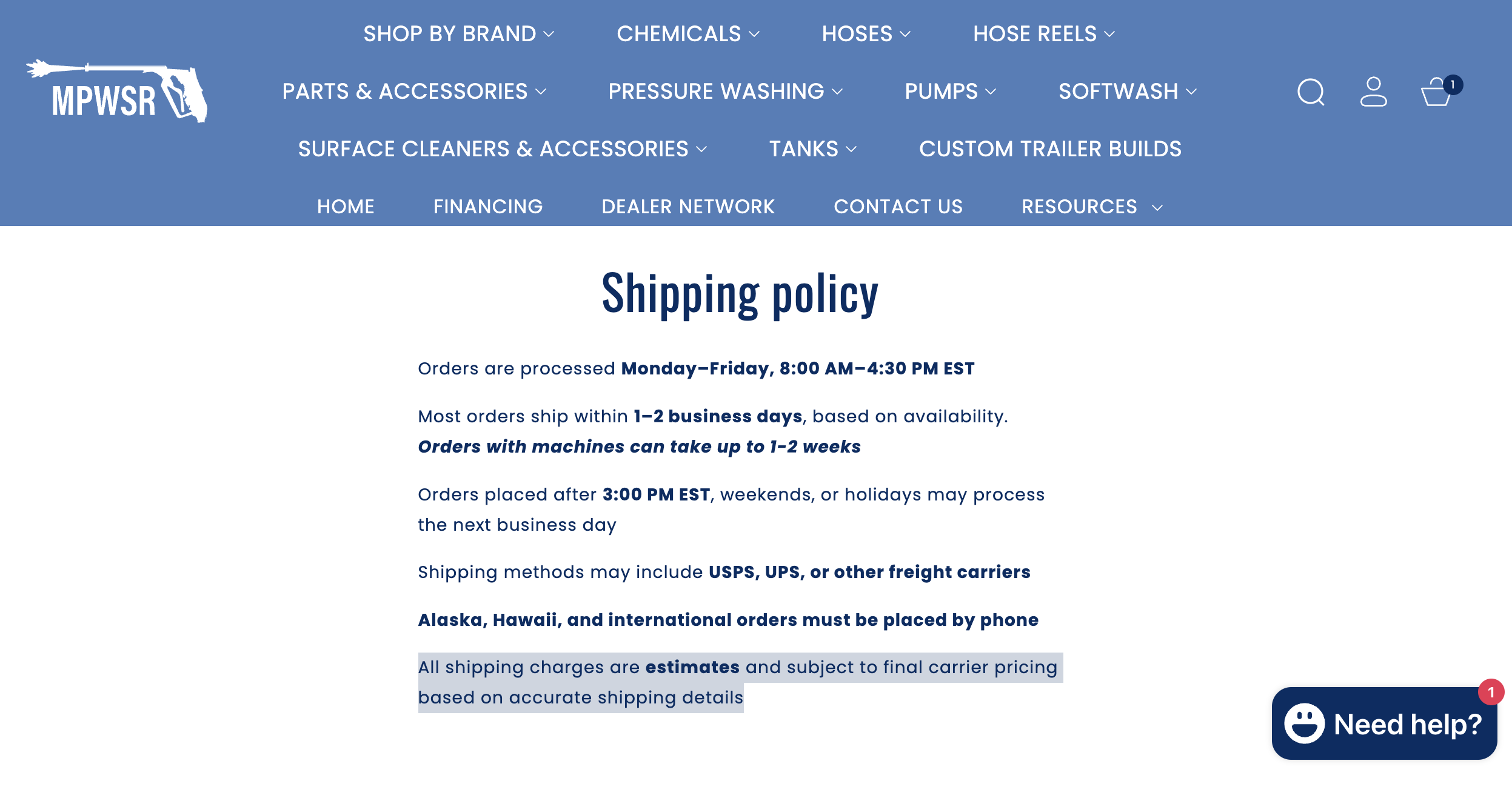

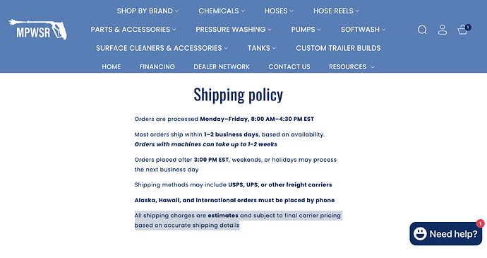

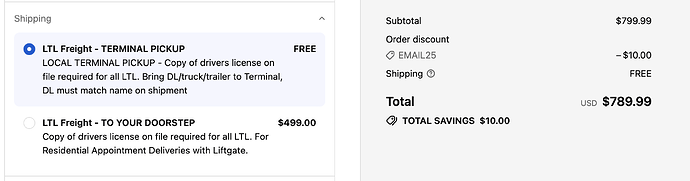

I got the same thing when I added it to the cart… if thats a true, thats a steal. But based on Manatee’s own policy page, I’d expect a follow-up call or shipping adjustment after the order is placed. Everywhere else I’ve seen them for sale it’s the same base price, plus $100-500 for shipping (free pick-up obviously).
I just got of the phone with someone named Marissa, they confirmed it is free shipping on them.. gonna order myself one
Thats a no-brainer then.
