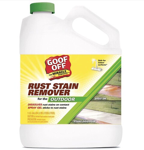

So what is the best way to clean sidewalk with rust??
Is it: pressure wash then rust removal ? What about a post treatment ?
Or
Spray rust removal wait pressure wash then post treat.
Have some side walk work coming up just trying to figure the best process
All this is is oxalic acid premixed. For $15 you pay for that stuff you can get enough oxalic to make 10-15 gallons.
I always pressure wash first. One or two applications of oxalic and I walk away.
