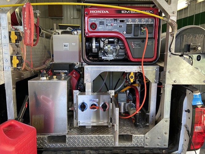

I’ve seen 2 different set ups for a 3-way valve to flush the SH line on a proportioner. Some put the valve right at the proportioner which sounds great for easy access, but then you’ve got 12.5% SH sitting in your line indefinitely. Other guys put the valve right on their bulkhead to the SH tank, so the whole line gets flushed along with the proportioner. Any thoughts from you all who have used this set up?
At the proportioner works just fine. Bleach can stay in poly braid line for years. Think about your downstream line
Just off to the side but I know a lot of guys put it on top of the sh line.
Sorry if I’m detailing a bit here, but do you have a couple more pics of your skid? Particularly the exterior. It looks enclosed? @Molski
@softworks I can get you some tomorrow when I head to the shop if you like. It’s not enclosed. Booster is under the generator. 3 seven gallon soap tanks behind and then two 100 gallon tanks one 100 sh tank. Tool boxes on the left have ro/di stuff in it.
