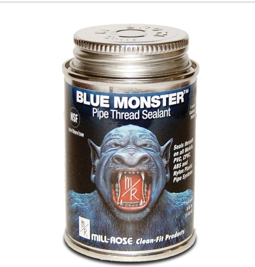

I use blue monster on mine and have no air leaks, you can get some at home depot.
