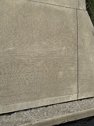

This is a first for me… My process has been consistent every time I’ve cleaned and sealed a driveway, so the list of variables is short. I’ve narrowed it down to a few possibilities:
  • A bad batch of sealer — although I used 15 gallons total between this and another job the day before (which I can actually see from this location), and that one turned out fine.
  • Moisture may have gotten in during the drying period — possibly from a sprinkler system running early the next morning or maybe even heavy dew? What’s strange is the issue only shows on this section of the driveway, not the patio, which was cleaned and sealed the exact same way. I also wondered if the sealer flashed too fast since it was applied later in the day and in full sun.
  • Something with the concrete itself — maybe leftover sealer in spots, inconsistencies in the pour, or some other surface issue?
I just can’t wrap my head around why this particular section came out so poorly. I’ve already reached out to the manufacturer for guidance, but if anyone has seen this kind of thing before, I’d really appreciate any input to help me figure out what went wrong.
In the meantime, I’m planning to go back and use a stripper (possibly Flood Wood Stripper?) to remove the sealer, then clean the area again and go from there.
Before cleaning (I don’t have any after cleaning but before sealing):
After sealing (25 hours later):

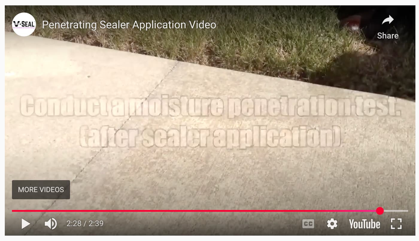

I was looking into it more, and one of the videos I found shows a very similar appearance. I’ve just never seen it this pronounced prior to now.

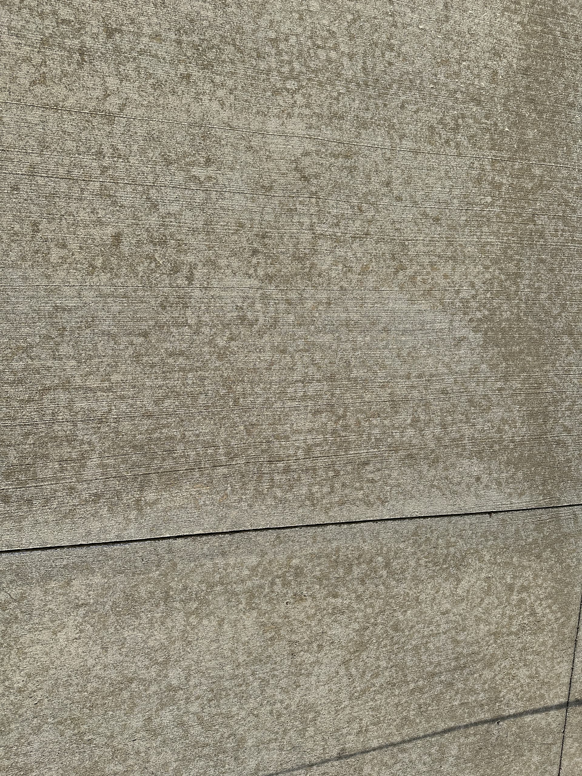

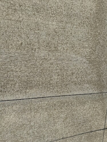

I had already reviewed that information, but I’m not convinced what I’m seeing is a deposit. It looks more like the concrete didn’t absorb the sealer evenly. Since I used three 5-gallon buckets over the course of two jobs across two days, and this is the only area affected, I suspect the issue may be with the concrete itself.
I’ve used both penetrating and topical sealers from various brands, and up until now, V-Seal has delivered the best results for the cost. I’ve completed about ten sealing jobs already this year using the same process on various substrates, and this is the first time I’ve seen something like this happen… so I’m just as puzzled as anyone.
Yeah, I agree it definitely doesn’t look like white deposits.

No hot water, so I’m hoping a quick pass with the surface cleaner will take care of it tomorrow. That said, this is unlike anything I’ve seen before. The owner mentioned the driveway has been cleaned and sealed twice over the past six years without any issues so I’m baffled. Really hoping I can avoid having to strip it.
I followed the procedure provided by the V-Seal rep:
Overapplication of V Seal 101 sometimes results in white precipitate (deposits). Washing with water and scrubbing the surface will remove the white deposits.
even though, as both @qons and I initially suspected, that wasn’t the root of the issue. I went ahead with it anyway to rule it out, and as expected, it made no difference.
