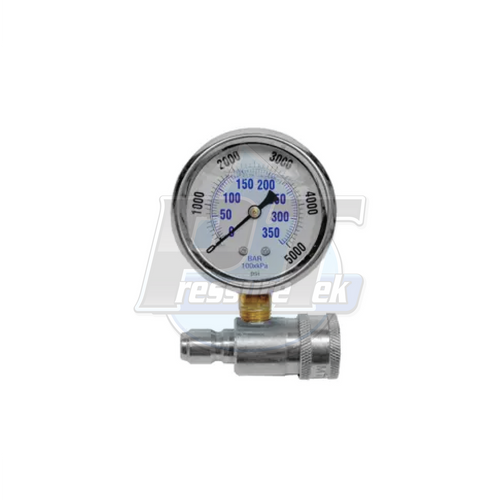

If it’s a pressure based unloader, then you need a gauge:
Insert your zero tip and adjust your unloader while pulling the trigger on your gun to the pressure your pump puts out. Let go of the trigger and make sure that it only jumps a few hundred PSI.
There are better explanations here, if you want to do a search. Flow-based unloaders are different. :+1:
