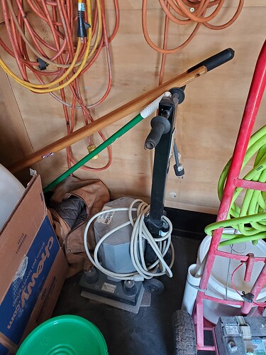

random orbital floor sander

Go with what surface therapy said for the floors, I use it too, a random orbital floor sander works great for floors. You can rent them but test it at the rental place first.
