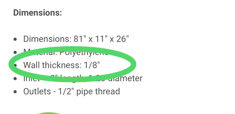

But I’d be most worried about this detail:
That’s really thin for a plastic tank. You’d have to build a box around it to keep the sides from bowing out.

Rv tanks are prone to cracking. Especially when someone travels with them full. They are not very strong at all. (Been in RV business for 6 years). I would pass

I’m an rv tech full time. If you make a cage for it you should be fine. They are thin and will bloat Without help. I’ve seen them put under enough pressure one bent the steel brackets holding it in a camper without breaking. Also seen them frozen splits are pretty rare but that could change with uv exposure
