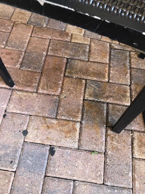

I just wanted to get your opinions on this before i quote this customer. This is a restaurant store front and has some rust on their pavers from the table and chairs. Normally ill use oxalic acid or F9 Barc if its concrete but is that safe to use on pavers? I’m afraid of staining the pavers or taking the color out.
They want me to quote to clean and then quote to re-seal the pavers. Im going there this week to take a look at it but i don’t know if they previously had any sealer on the pavers. So I’m unsure what products i can use to clean that wont stain. I also was curious, if they have old sealer, will the rust come up if i strip it? I attached some pictures that they sent me. Let me know what you guys think! Thanks in advance!
IMG_1215|360x480 IMG_1213 IMG_1214

It works just fine on pavers. The only difference is etching. Because there is color in the pavers there is a potential to slightly dull the area. To avoid this being noticeable you should treat the entire area. No spot treating
So your saying treat the entire area with either the Oxalic or F9 Barc, and it should come up? And then if it dulls a little, as long as its clean, and they approve me to do the resealing, the color should come back with a wet look i would assume, right?
I guess that could even be a selling point to get me the re-seal too.
After you clean, if the color dulls, you may look into Prosoco Sealers. They have a few that will color enhance as well as seal. They have gloss and matte finish types as well.
