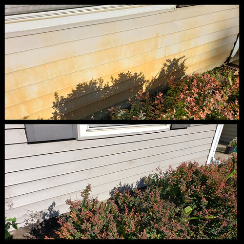

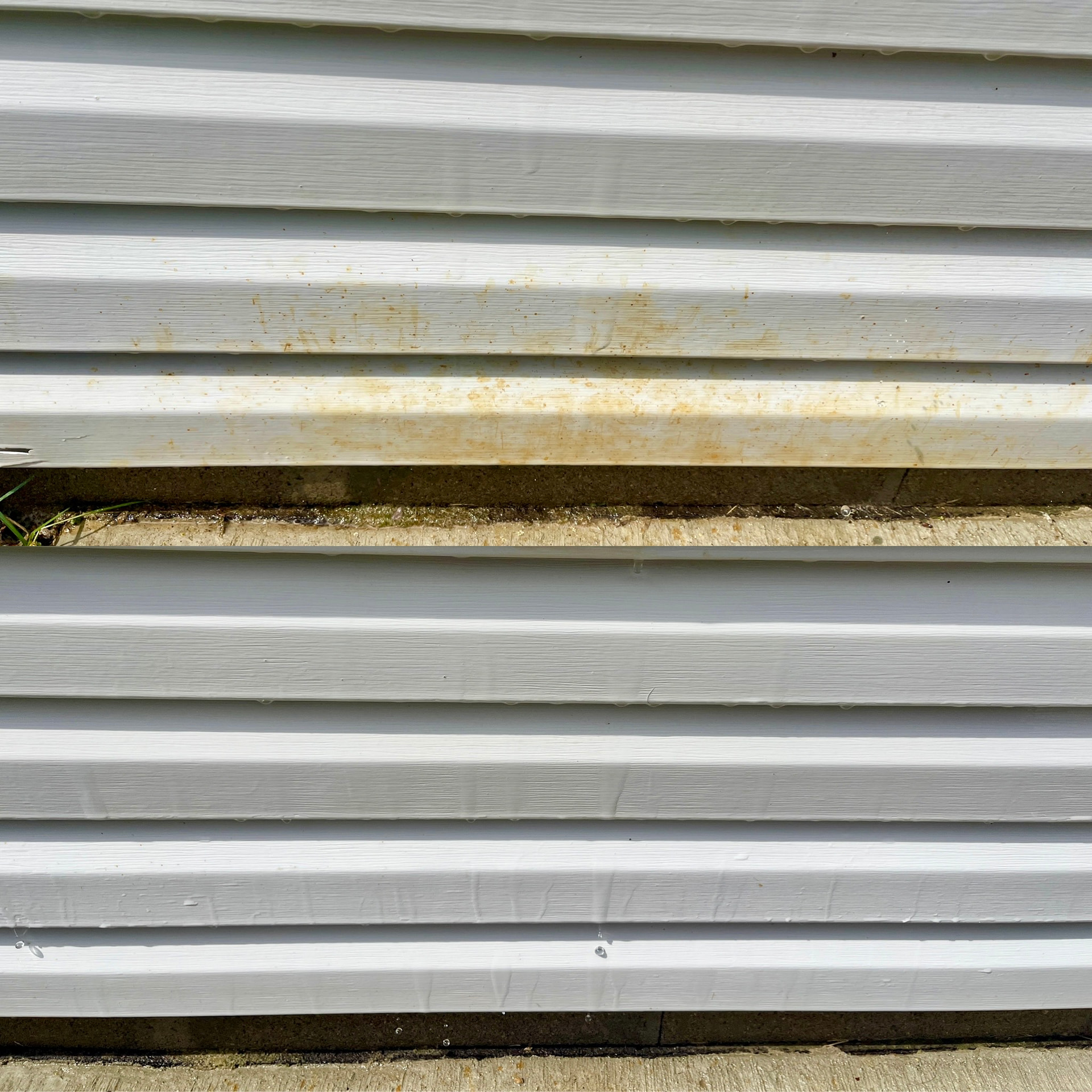

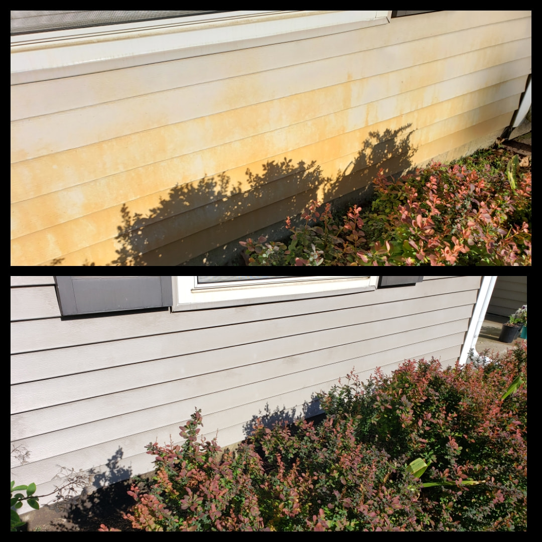

@Kentucky1234 and @Nickski, do either of those products work on rust stains on vinyl siding?
100%, aluminum brightener is the only thing I’ve used for rust on vinyl. 50/50 in a pump sprayer and it disappears in seconds
