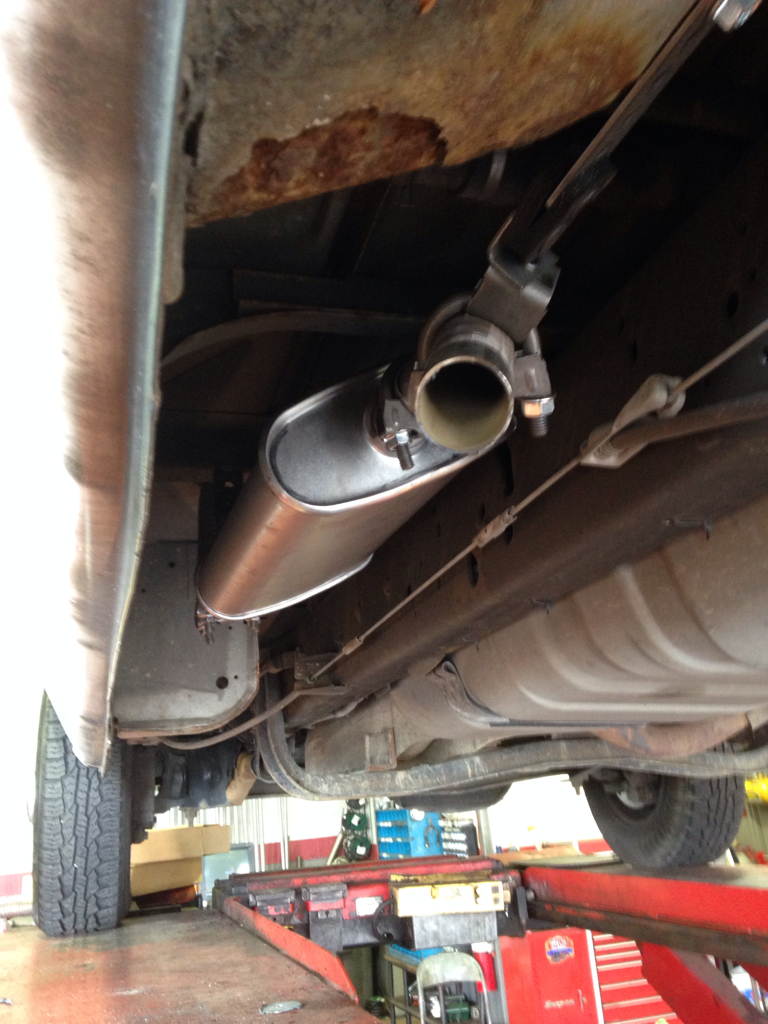

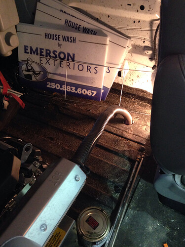

I’m booked for 9 am tomorrow morning at my muffler shop. Talked to the tech and he said he is going to get a small muffler mounted for me. He said it will be a bit more back pressure but he doesn’t think it would hurt the motor. We’re going through the floor of the van and out the bottom for the muffler to connect. Should be interesting! I’ll post pics of my whole E 250 custom build when the muffler is mounted!
Alright guys, here it is. I’ll post more pics after I test her out. Just leaving the muffler shop now. $200 hopefully well spent. Going to test it out as soon as it’s off the hoist!
If you have problems, you may be able to rejet the carb to adjust.

Ran my first job today, all most all of the exhaust noise is muffled and re directed but the actual engine noise is what I am hearing now. Not bad at 15 feet for a conversation. If you close the side van door and run a fan out the back I’m sure it would be really quiet. I don’t seem to have any power loss or anything of that matter as of now. Big resi job booked tonorrow for more testing
