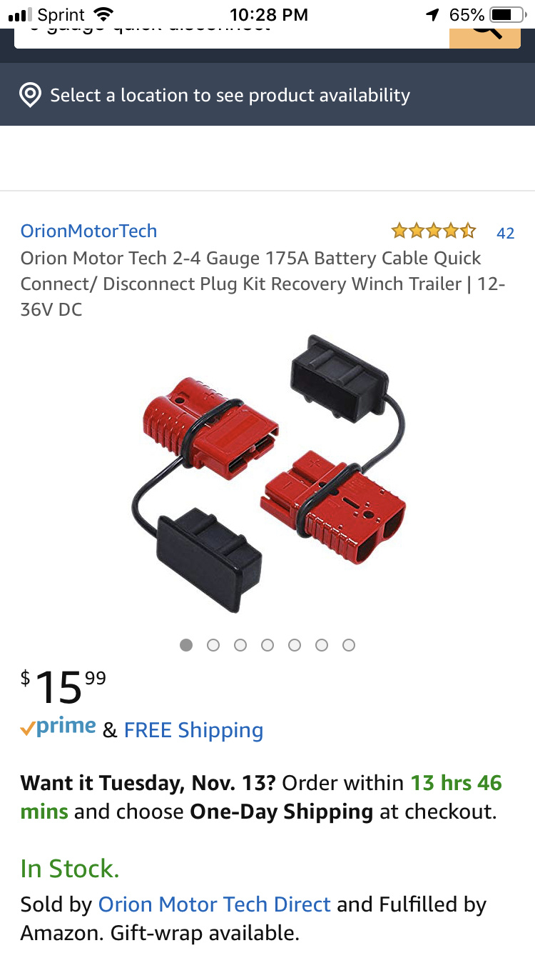

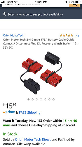

I saw a video where a guy used a battery isolator and big fat battery wires back to the trailer. Alternator charged it. You have to plug in the trailer twice. First your 7 pin, then the two battery cable connects like on a forklift. I’ll try to find it.
Might have to upgrade the alternator.
Like these
There’s been a few times when either my 12v battery has ran out of juice, or I forgot to charge it. I hook up jumper cables to my 12v hot water skid. It doesn’t charge the battery but it certainly runs it in a jam. Waste gas running the skid, but it works. This isn’t relevant to the post, but I threw it out there anyway.
I get those off of UPSes. I forget what they’re called. Maybe Johnson connectors?
We use those types of connectors on a few car trailers with winches mounted on them to keep the battery charged up and let me tell you it is a noticeable difference between running a dual battery diesel truck and a single battery gas truck. I’m certain it would be perfectly fine with a 12 volt pump.
They’re Anderson Power Pole connectors. Don’t buy the off brand as they are junk. You’ll need a crimp tool for the pins
