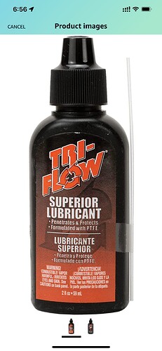

I wd40 all door locks after a wash just to be safe. They do tend to get catchy after a wash if not taped off. Also what did you use to restore the door?
I use triflo it’s amazing. Was recommended by my locksmith buddy.
