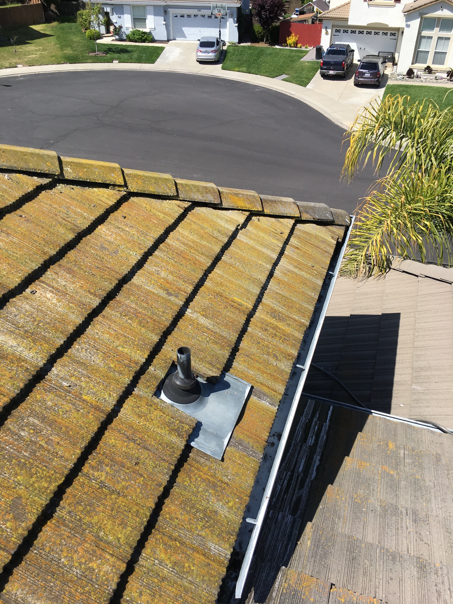

Hi Guys,
The pictures above are after shots on a tile roof that didn’t clean up at all. I used 10% SH diluted down to 5% plus surfactant from a backpack sprayer. I have used this same batch of bleach, before and after this cleaning, and it has worked just fine on heavy moss. This roof was not moss, but an organic growth that was green and red, flat against the tile. When I applied the solution it became very bright red; by the end there was no improvement at all. I then tried a much hotter mix on a small area; still no effect at all. I should add I allowed the initial application to dwell around 10 to 15 minutes before taking the pictures. Any advice would be appreciated.
If it’s organic growth SH should take care of it. If I had to guess you probably weren’t able to apply enough mix using a backpack sprayer. Some growth really needs a good soaking.

Buying the 12v set up is in the works. But I did soak this thing completely, and I went over it more than once. It was so ineffective I assumed I had bad bleach. But that can’t be because I used it on a roof wash a few days later and it did great. You are right about the backpack, though. I got a burn on my back as well a few days ago.

That looks like lichen to me.
It does take quite a while to fall off. I’d go with a stronger mix. Roofs are generally very bad in our area (pacific northwest). I start from 6% on concrete tiles and often do 7% or even 8%. I always do 6% on asphalt.
When it’s that hot and sunny (from your pic), prewet is a must. I’d prewet it twice. Really cool it down.
If it’s like this heavy lichen, I’d talk to the customer, set the expectation right.
I was told by a pro I trust that sodium percarbonate cleans lichens better than SH. I have never tried it though. I’d offer the customer an option of me combing back to treat it again with SP, just to make it work faster. I never seen anything like this though. Most roofs I clean are heavily infested with moss, some have a little lichen, nothing like that.

It would be very strange to see lichen grew like that. So, it might not be lichen.

rust?
It didnt seem like rust. It was shaped like lichen but red, and then became very bright red when i applied chem
That is referred to as artillery fungi. SH will kill it over time . Along time . Using a mix with caustic soda bead in it will kill it in a few days . That may beat the worst case I’ve ever seen
Use one cup per 5 gallons of 50/50 mix and reapply. I wouldn’t be surprised if it takes more than one application.
That’s helpful. Thanks. I’ll add some sodium hydroxide to my supplies.
