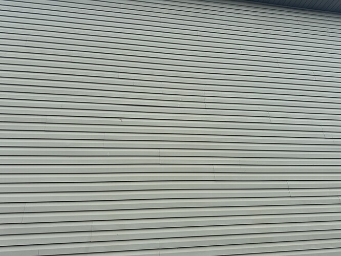

So this roofing company had some shingles drop on the siding. The siding is oxidized not the worst I’ve ever seen. I think degreaser would take up the scuff marks but then there will be spots that oxidation has been lifted from the surface. It’s random spots all over the house so it would be intensive. Do we need to lift the oxidation after or before? Just need to make sure process is correct. Haven’t done any test spots yet. Also looks like they tried to clean it already or hired a monkey to wash the house previous…
Don’t make someone else’s problem your problem. Let the owner know what you can/can’t do. Show them the results of the tests, set expectations, and charge accordingly.
I get that im just trying to figure out if I need to lift the oxidation first. Then go in and hit the marks with some degreaser. If I just went and hit all the random spots that scuffed up the siding it would look like random clean non-oxidized blobs everywhere.
If the customer is willing to pay for the oxidation removal it would be the last thing I would do. Remove the staining, remove the organics, remove the oxidation.
Ok that’s what I was thinking as far as order. Thanks man. Definitely gonna be a lot of ladder work on a decent slope so gonna make it worth the time for sure.

Degreaser not acid nor scrubbing with both took scuff from shingle off. Was recommended goof off built manufacturer. We shall see. All testing to make sure it works in small spots and with permission from home owner and roofer. The clod company is reputable so I know they want it done right. They also understand the problem it will create. My question is will goof off work and will it remove oxidation. I imagine it will if scrubbing is involved.
