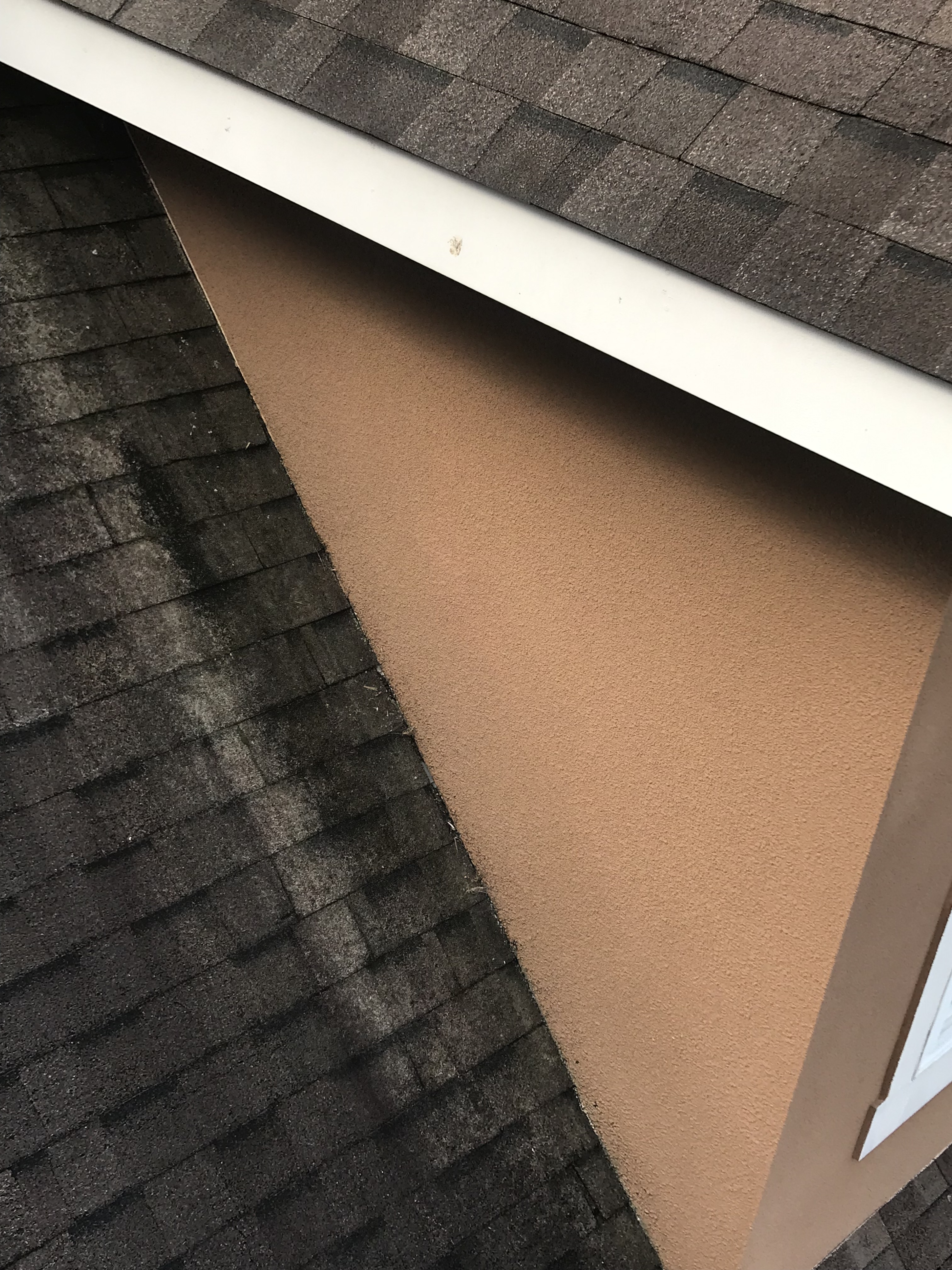

This looks like painted stucco. I have a roof cleaning job coming up and worried it will mess up the color from some splatter of the mix. What you think?
Should be fine. I clean colored (that color too) stucco all the time and put hot mixes on it. If your worried, wet the wall first and keep it wet.
Awesome. I usually don’t worry when it’s already white but with it being a dark color I was hesitant. Thanks
Still do a test spot with a 50/50 mix, just to be sure. You never know
Is it actually painted or is it just the color of stucco? New stucco is colored before applying. SH doesn’t normally hurt that. If it was actually painted years later it probably depends on the paint. If it’s painted I would definitely test it as recommended above. If it’s not paint I wouldn’t worry about it but always good to test.
If it’s paint I’d be sure to wet it down before and lightly rinse right after applying your mix. Hopefully you the test turns out good and you don’t have to worry about it.
