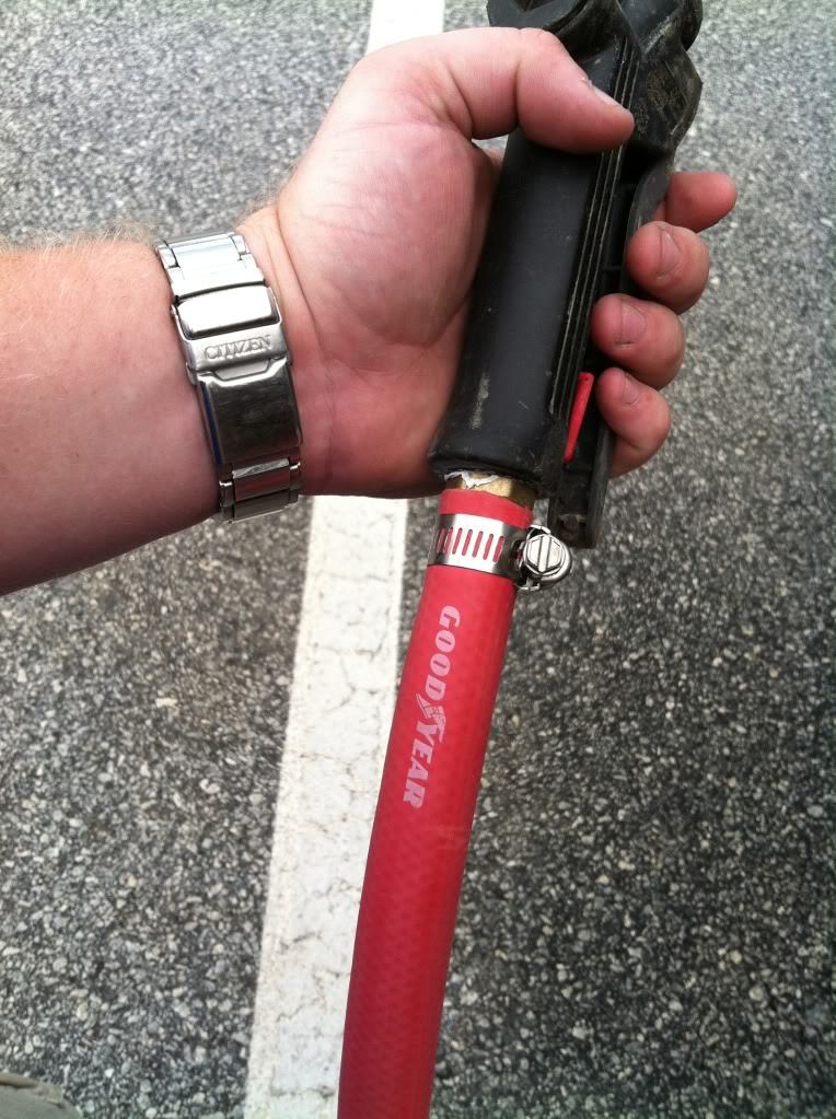

just to be clear thats 5/8" garden hose with the ends cutoff? correct? like this
http://www.homedepot.com/Outdoors-Garden-Center-Watering-Irrigation-Hoses/h_d1/N-5yc1vZbx4e/R-100580705/h_d2/ProductDisplay?catalogId=10053&langId=-1&storeId=10051
Yeah, we use same hose here for roof cleaning. It works great for me.
