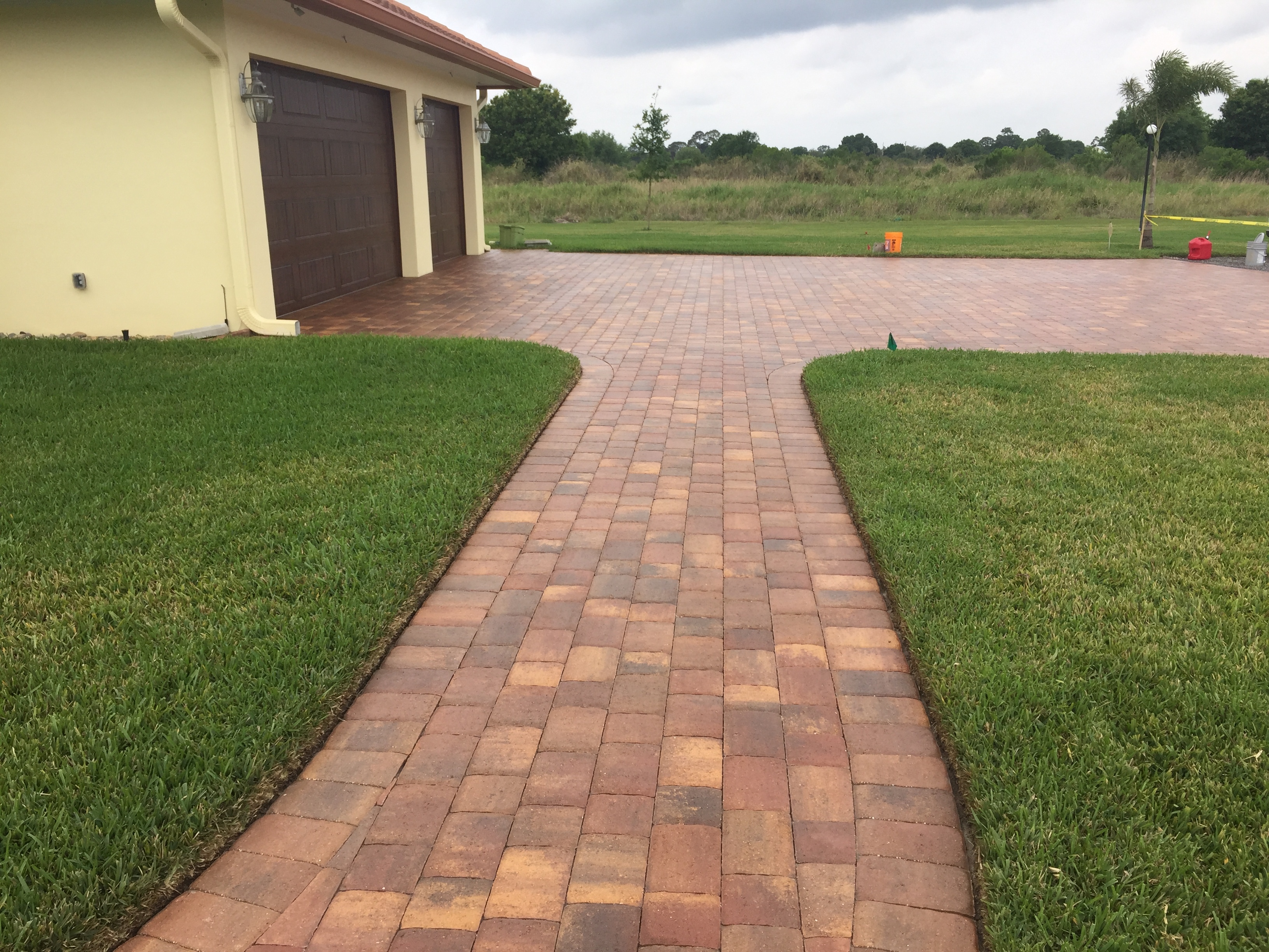

We use a product called PWS-8 and spray it on. It’s expensive but goes on easily and our customers love it.
What about seal n lock ???
Never heard of it.
Normally, how many gallons do you use of the pws-8 Mr.Fixit?
I can’t remember what the coverage rate is. I’m sure you can look it up. But, I recently sealed a brick home and only used 6 gallons for the entire home.
