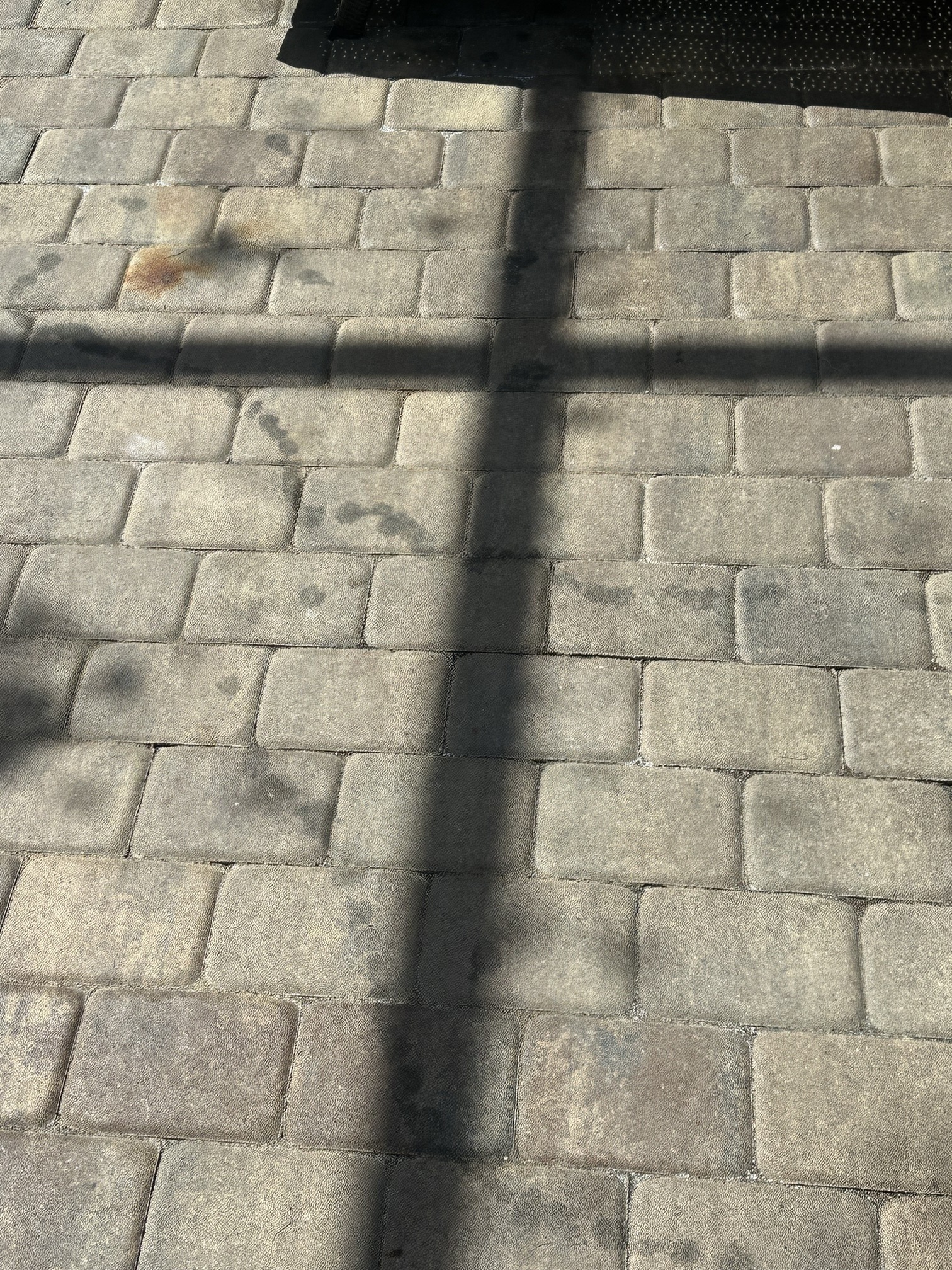

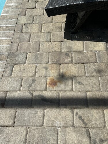

Anyone know how to remove these black stains. The rust I think I can get up but the black ones I have no idea
What have you tried so far?
Do you have any hints to what the stain is from?
That’s the shadow from the beams from the screen enclosure.
Just kidding
That looks like the grease that spills from a grill cup. Or like charcoal water from a grill.
Try a degreaser, I highly recommend r202 which is one fellow PWRA recommended years ago and I’ve been using ever since.
Not sure if a degreaser would remove it but it’s worth a shot, also use the surface cleaner or a turbo nozzle, gotta push out any grime stuck in the pores.
For rust we use oxalic acid purchased from Florida labs on Amazon (mix 6oz/gallon, max). But for touch ups like that you can also use barkeeper’s friend which also has oxalic in it. Scrub it in, let it sit then rinse.
