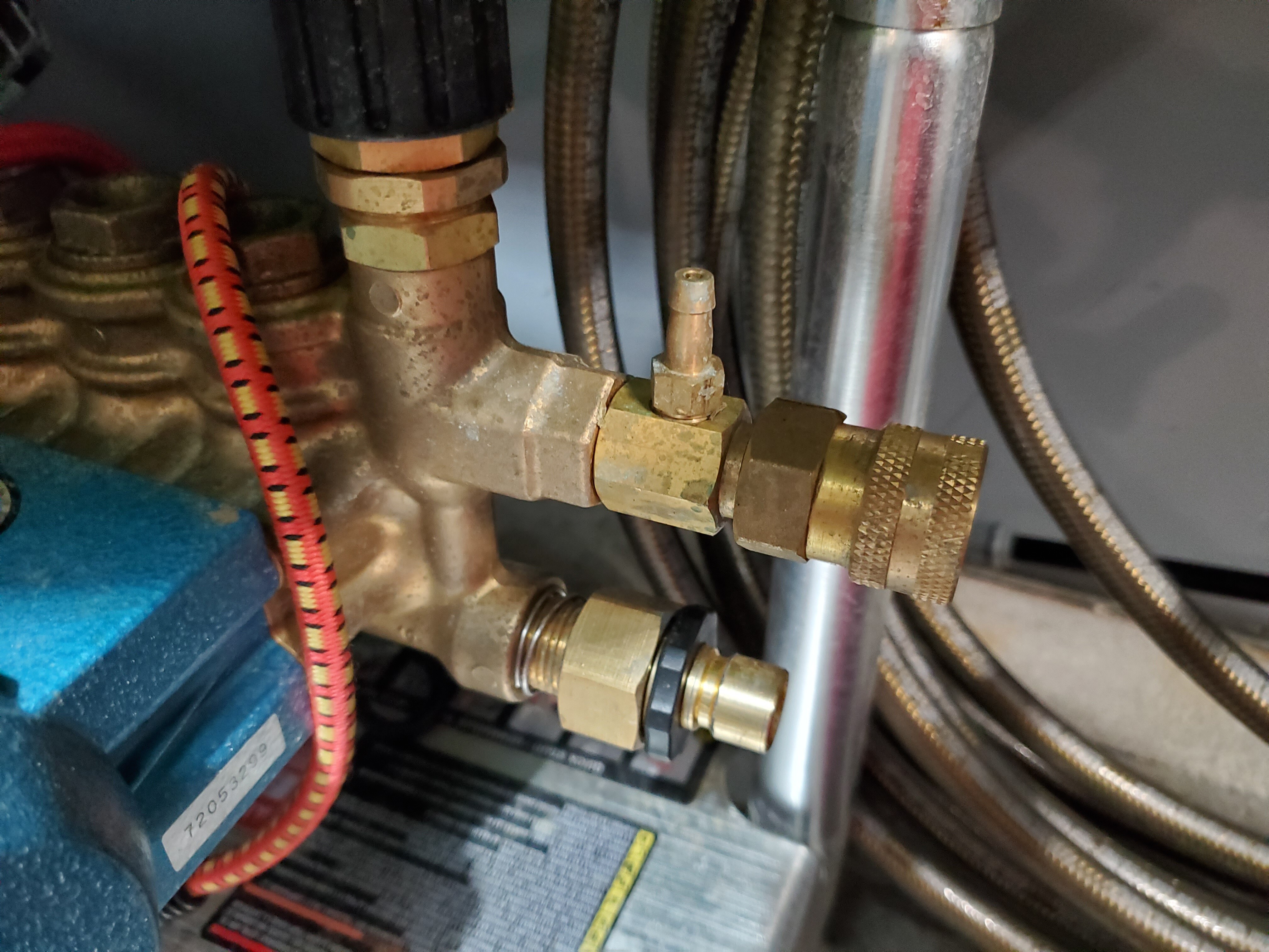

Since I don’t use it and never will, would I get more flow of I remove this injector, or is it not even worth messing with? It’s on a 4/4200 machine.

So I finally got around to pulling it off. I can’t remove it completely because it’s a special fitting on the pump end, fine threads and o-ring seal. I did remove the screw in orifice in it though. It necks down pretty small, about the same size hole as my #8 1000 psi tips. I haven’t tested it yet, but I have to imagine removing that will help get even more flow.
There is a check valve inside as well. I assume that’s only there so when it’s shut off chemicals can’t get back into your pump? I just took it out too since I won’t be using the injector. That’s fine to remove that too and just gut the whole injector right?

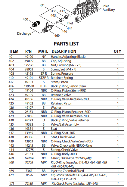

I found the correct fitting for a cat 67dx pump. The part number is 126974. Its a replacement for the injector (part number 7367). Don’t remove the check valve parts (see 471 in the diagram).
