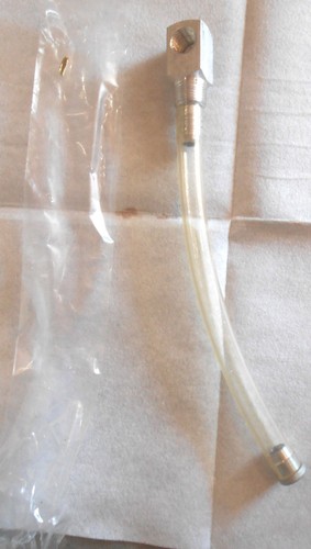

For installing a pickup tube in that tank you really just need to reduce down. I would completely remove the big 2" valve. I would just buy some sort of universal pickup tube and reduce down until it fits. You don’t have to use those quick connect fittings. It’s not like you’ll be unhooking them very often. If it were me I’d cut them off and just use hose barbs. Although, I’ve never used quick connects for fuel lines so maybe some people like them.
You could use something like this. You just have to make sure it’s long enough. You can always cut it and make it shorter. You add a hose barb to the female port and it’s threaded right below the square head so you can screw it into your tank where you reduced down. In the case of this pickup tube you need to reduce down to 3/8".
Here’s a reducer that will get you from 2" down to 1/2". You then need to get to 3/8" if you use the pickup tube from ebay or similar.
Here’s a 1/2" to 3/8" bushing. That pickup tube should thread right into it.
