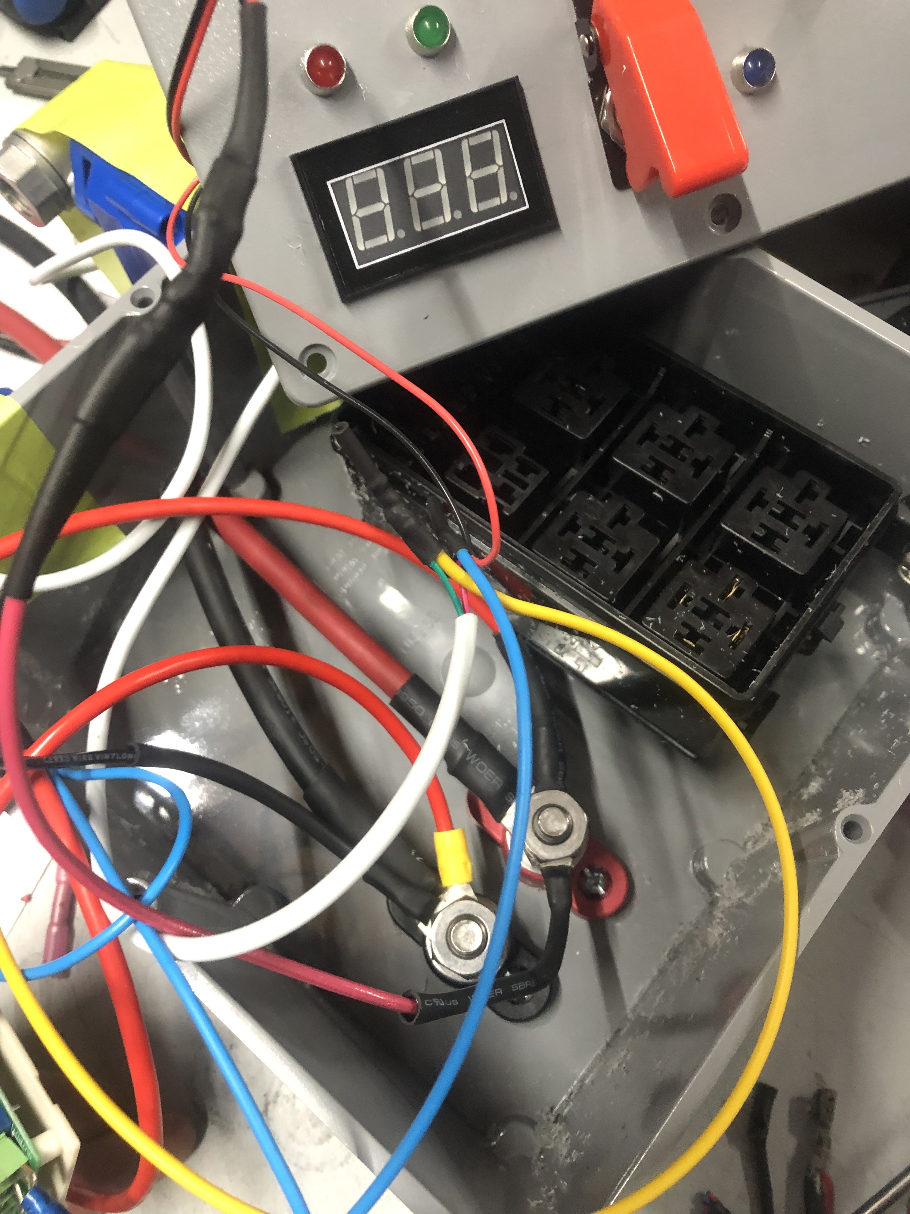

I’m having some problems selecting the right valve combinations from the selection of US Solids. I want water flowing when soap isn’t. Did you end up going with one electric ball valve(HW) and one NC solenoid(water)?

I’m building a system with one 3 way ball valve. A high quality ball valve that will hold up to the chemicals for (hopefully) many years. As long as you wash it out at the end of the job that is. I am not a fan of multiple NC NO valves. Just a lot going on that can go wrong. IMO
Nope. It’s still sitting in the same position on the bench as the pictures above. I came into some money that I’m trying to buy an investment property with and in between getting cold feet on on one and learning a whole new kind of math it’s taking a ton of my time.
Anyway, I bought two electric ball valves and a two channel remote so I can turn one on at a time and one is water and one is SH. Ultimately, I’ll have to turn one off before I can turn the other on. It won’t be automatic.
Hows you DS system working for you any problems so far?
Finally took some time to work on this thing. The remote was advertised at 1000m range. I went to every corner of my yard and the ball valves opened. Pretty pumped to finish this up.
I like the volt meter myself. Is it just wired into your wire coming from battery?

Wire an blue led for visual confirmation of open valve
Yeah. One wire to red and one to black. Couldn’t be simpler.
That’s what red and green are for. There’s two valves. One for soap and one for water.
