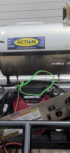

Burner only works intermittently. A lot of times its sprays diesel and won’t ignite. Adjusted the ignition coils and even then only ignites intermittently. When it does diesel fuel on the coils usually burns off. Anyone ever have a relay melt like this?
Yeah, I was going to comment earlier but got busy. I was gonna say I don’t think the relay was bad, but something within the circuit it is shorted. That spade that melted in likely the 12v that feeds the burner. 12v comes in through the 30 and then out the 87 when conditions are met. Trace the wire coming off the melted spade and see where that goes

As soon as they put in the replacement relay, it immediately started smoking and burning melting the wires inside on startup. Hadn’t happened before. The burner just slowly started lighting intermittently. This was an immediate burn. I think he said he put in a larger wire with the new relay in case it was over amped. Checked the fuses and none of them were blown.
There is an underlying issue and adding a bigger gauge wire isn’t fixing it. You or they or whoever needs to find out what’s causing jt. They just put a band aid on it by adding a bigger gauge wire
The wire didn’t help. They also added a different relay type. I think for a higher voltage rating. Whatever it was it immediately set on fire when starting up. The more I go and watch thr more I learn how to fix and not to fix this. I got the machine in November. Has about 125 hours and has had an entire blower motor assembly replaced and the burner is always on the fritz

They called and said the relay was connected wrong where the positive wire was connected to the ground.
Now mind you, before they replaced the relay the burner did work initially and over time it became intermittent and eventually it was discovered the relay slowly melted. Immediately after they put on the new relay yesterday the whole control box melted and smoked on startup.
So idk if the original relay was installed incorrectly and something else was the problem. I do suspect that when the new relay they put on and it smoked, they did so incorrectly and they are now identifying that mistake as the initial problem. I’m about to go pick it up now.
Now they’re telling me the relay was always connected incorrectly (positive to ground). Doesn’t explain why the burner worked as long as it did and why it never immediately started smoking and melting wires like it did right after they replaced the relay and the wire.
Also asked why a fuse didn’t break to trip the system before it happened and he said because there wasn’t a fuse before it. Now this rig is supposedly ready to pick up but after showing him fuses that were already on yhe system he said jt was missing a fuse and just went to get one. Waiting for him to add one.

In december (one month after acquiring the rig) they had to replace the burner fan (beckett brand) because it was defective. (Important note, it was replaced with a wayne brand burner fan. Alkota’s wiring diagram states that Wayne brand burners require a fuse to be added to the circuit. Mine came with a beckett and therefore no fuse had been installed prior. It should’ve been added when they replaced the fan but it wasn’t)
Today I found out they never added a fuse to the circuit when they put the wayne burner fan on. So whatever was causing the power relay to melt wasn’t stopped by a fuse.
Importantly, it was never found what was causing the excessive amperage/voltage that melted the power relay in the first place. They claimed that the relay was wired improperly from the getgo with the power supply wire being attached to the ground of the relay. If that were the case this relay would’ve caught fire immediately months ago and I’d never have had a working burner (and it did work for a while). So that explanation makes no sense. The technician that replaced the relay had a different brand of power relay (with a different voltage rating to boot) than was on the machine originally. He said that he put the wires back in the exact same place as the old relay. The new relay and wiring immediately catches fire upon starting up. I think this different brand relay had the terminals in a different arrangement than the old and he connected the wires in the same position as the old relay, but to the incorrect terminals, causing the fire. He wouldn’t admit to such. Last month this same technician adjusted the electrodes and admitted to accidentally cracking one when tightening it and replaced it. Today he denied ever cracking it, stating it was cracked before I arrived last time.

Bad grounding connection somewhere… that’s my guess. Make sure there’s breakers in place & check the terminal connections for tightness.

Sounds like it was put together poorly, Wayne or Beckett there both good quality burners but it seems to me like the wiring isn’t right.

I wouldn’t say it’s a lemon, all these machines are put together from different brands different combinations, You’re burner is most likely wired wrong. A savvy mechanic will trouble shoot and spot the problem relatively fast. Remember all problems have a solution
