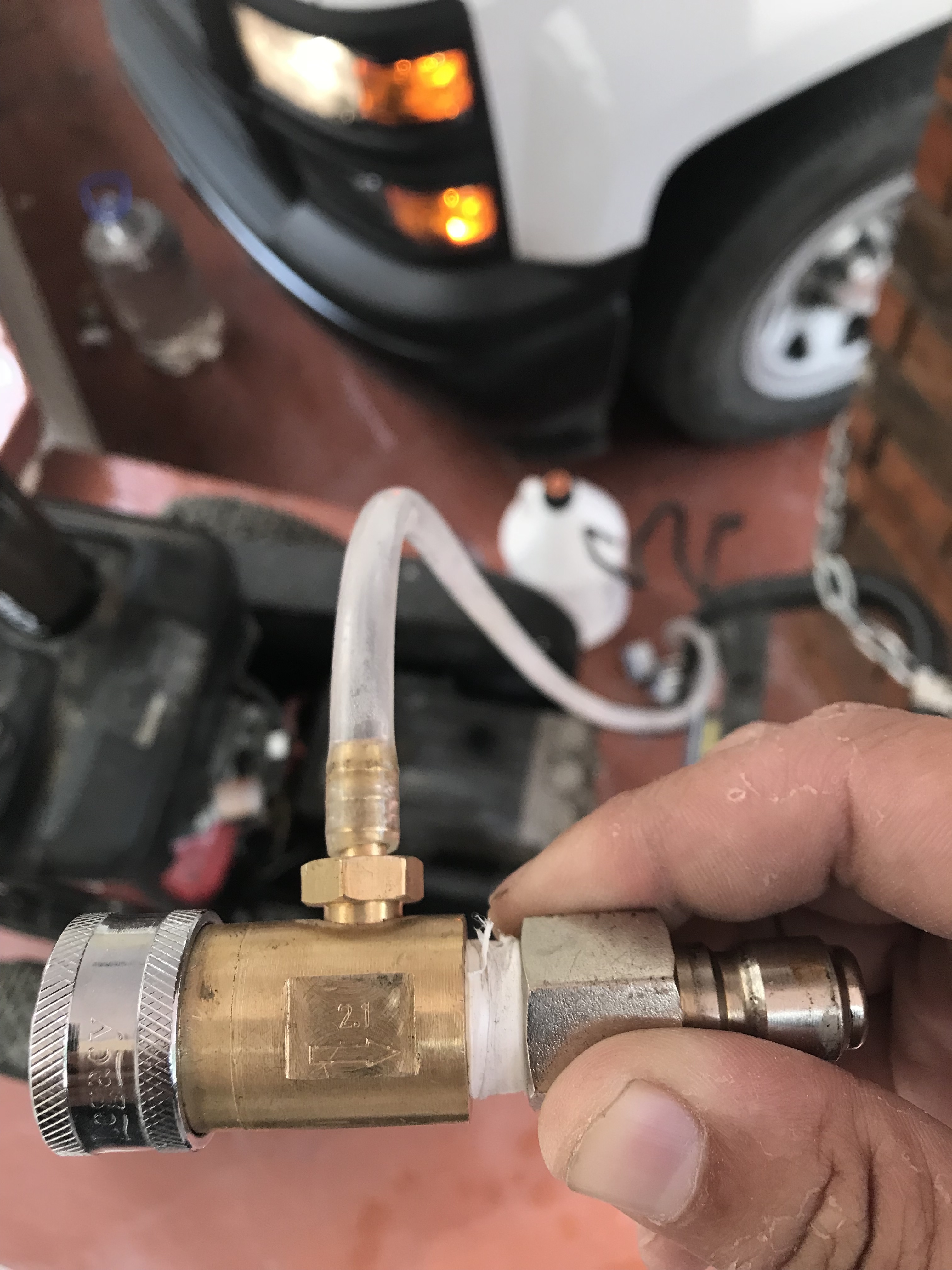

It only says 2.1 and has an arrow pointing out, my machine is a 4000 psi 4.3 gpm and the injector does not have a screw to regulate the flow. And still dont understand the ratio!.

That 2.1 that is having you disoriented is probably the orifice size, that tells you it’s ratings, and yours with 2.1 orifice is rated for 3-5 GPM machines, so it’s rated for yours, but smaller orifices than rated seem to draw more than rated.
That arrow you said it’s (pointing out) you guessed it, tells you the direction the water should go through, (out) :slight_smile:
