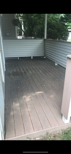

We’ve been doing composite decks about 3 years and althought our process is efficient it just may not be quick enough. We went out last season and looked at 88 small decks (no large than 6x10 half of them being second story) which they decided to push off to this season. I cant imagine the time we would be in it for 88 decks with our process so im reaching out to you guys for advice. How would you do it? Roof pump and a low % house mix? Im hesitant to do something like this, we once had a guy over shoot a roof and had some land on a deck behind a house and leave some spots but we were able to blend them. Since these lower level decks are covered, they seem to be growing a decent bit of algae and what looks like to be dark leopard print spots on them.

Biggest thing to look at is if it’s gen 1 or gen 2. Gen 1 set expectations, charge more because you might need 1000 psi on some decks. Gen 2 is literally the easiest thing to clean. Pictures you posted we would be at $70 per deck.
How can i tell the difference between gen 1 and gen 2? These buildings are older so i can only assume gen 1. Every composite deck we’ve done ive always use the same process
Texture. Gen 2 is fully encapsulated. It has a sheen to it when clean, just like vinyl siding. Gen 1 has a rougher texture and duller look. It is porous, and prone to wood related staining like tannin stains.

Gen 1 can change colors with a strong mix. If it’s gen 1 I would walk. I’ve cleaned enough if them to know its a crap shoot. Most gen 1 have been slaughtered with pressure from previous contactors and are very porous. Any other type of composite i use my house mix and rinse with jrod. If its really bad and some what beat up I use my 12 volt with a weak mix and rinse the same. A white pressure tip can remove the protective layer of newer composite. Never use pressure. I’ve used a deck brush plenty of times on decks. It only takes a min to scrub a large area that might not be reacting well to your mix.
im going to take another ride to the site tomorrow and share some more pictures before anything. Hopefully with more detailed pictures you guys can confirm gen 1/gen 2 and help me out as far as mixture.
