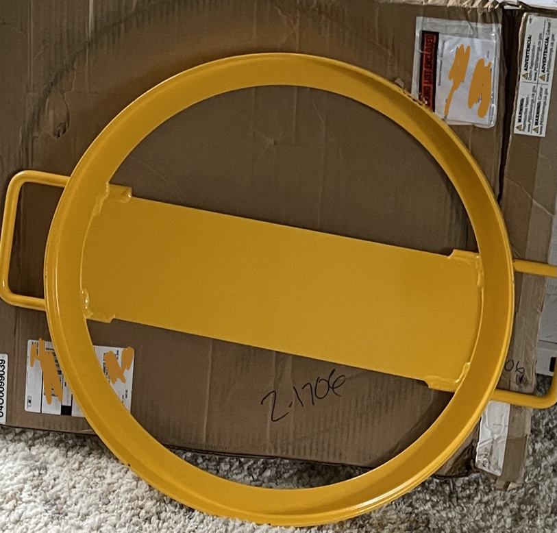

This is a good way to strap it down.
Link
I use it to transport my pickups from my supplier . What do you think ? Maybe welding on two more handles between the existing would be more secure as well
I don’t think so, but it’s not on my trailer so it doesn’t matter I guess. To much money to be made in this business to be using drums anyway.
